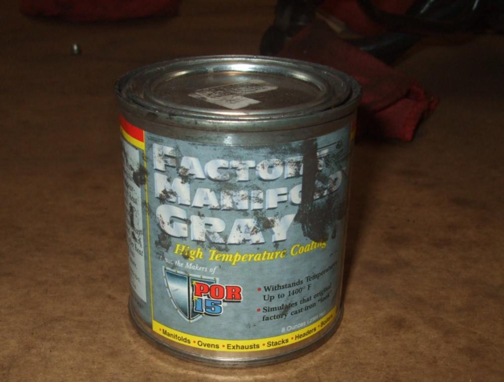

        But I have found an unbeatable coating for the head pipes, on back to the tailpipe ends.
        There is Cold Galvanizing Zink in spray cans used for among other things, the welds on galvanized Chain Link Fence Posts, this absolutely WILL NOT rust through, and will not burn off.
        Even if you bought Aluminized Steel Pipes, the seam welds will rust, so that is what I use with excellent results.
        This way, the exhaust system will last a good 20 years or more without the unnecessary expense of Stainless Steel Pipes.
