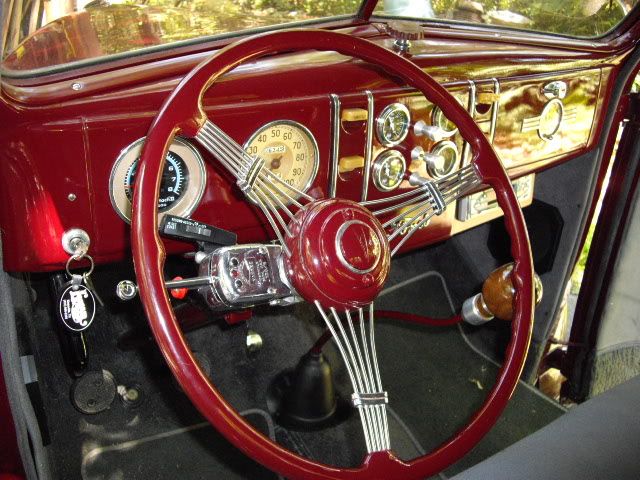

            I won't try to talk you out of Schrocks as their work is restoration quality but if you want to try to do it yourself and save a good bit of $$ then it's cheap to try.
            This banjo wheel from my 39 Ford was missing large chunks and had a number of cracks. I undercut the remaining plastic areas and used POR 15 epoxy to mold the sections by hand with rubber gloves. A lot of sanding priming and painting left me with this. These pictures were taken prior to selling the old girl to buy my Avanti and the wheel had been repaired for more than 15 years.
            [IMG][/IMG]
            It doesn't cost much to try if you don't need resto quality.
