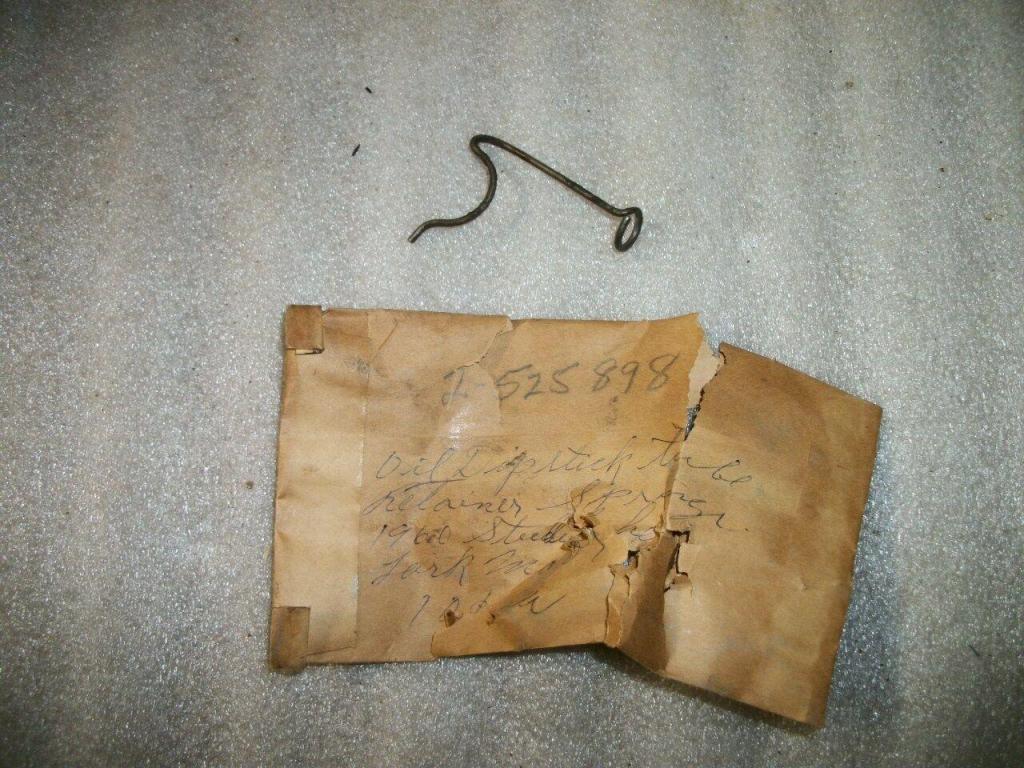

    StudeRich Can you tell me if I have the correct dipstick tube for a '54 Champion?
    And can you tell me if this is the correct clip? And do you have any tips on the install? The tube seems to have zero wiggle room. Not sure how to get it in place!Click image for larger version

    • StudeRich
      StudeRich commented
      Editing a comment
      You Got IT Daniel ! I also answered your SOS, Emergency PM Message!
      None of Your 4 Photo attempts worked, so this does work!
      Glad I could help, you should be good for Tomorrow with some Light.
    • Charmedlife
      Charmedlife commented
      Editing a comment
      StudeRich you are THE man! Thanks so much!
    • Charmedlife
      Editing a comment
      Another couple questions, Rich... is the tube you see with the ruler next to actually supposed to fit into the hole that leads to the oil pan? Or does the retainer clip simply assist to holding it in place above the opening as the dip stick travels through both the tube and the receipt hole? Am I right in imagining that the smaller end to the left of the flange is what would be inserted into the hole (or rest on top of it, supported by the dipstick and retainer clip)? (I hope I make sense!)
      I realize that there are only a few different ways that this COULD be done, and that when I get into doing it, the answers will be more obvious. So, I will check this thread when I wake and deal with it with confidence if I don't hear from you. Thanks again.

  • #18
    Success in installation! Thanks StudeRich!
    • StudeRich
      StudeRich commented
      Editing a comment
      SEE how Easy that was? Sometimes our "Armchair Installations" make things seem a LOT harder, than actually DOING IT!
      Short end of the Tube into the Block, small end of Clip on the Tube, and Large end Under the Starter nose, Done!
      I'll bet some Stude. Employee got a $100.00 Reward for that Cheap Fix Idea!
