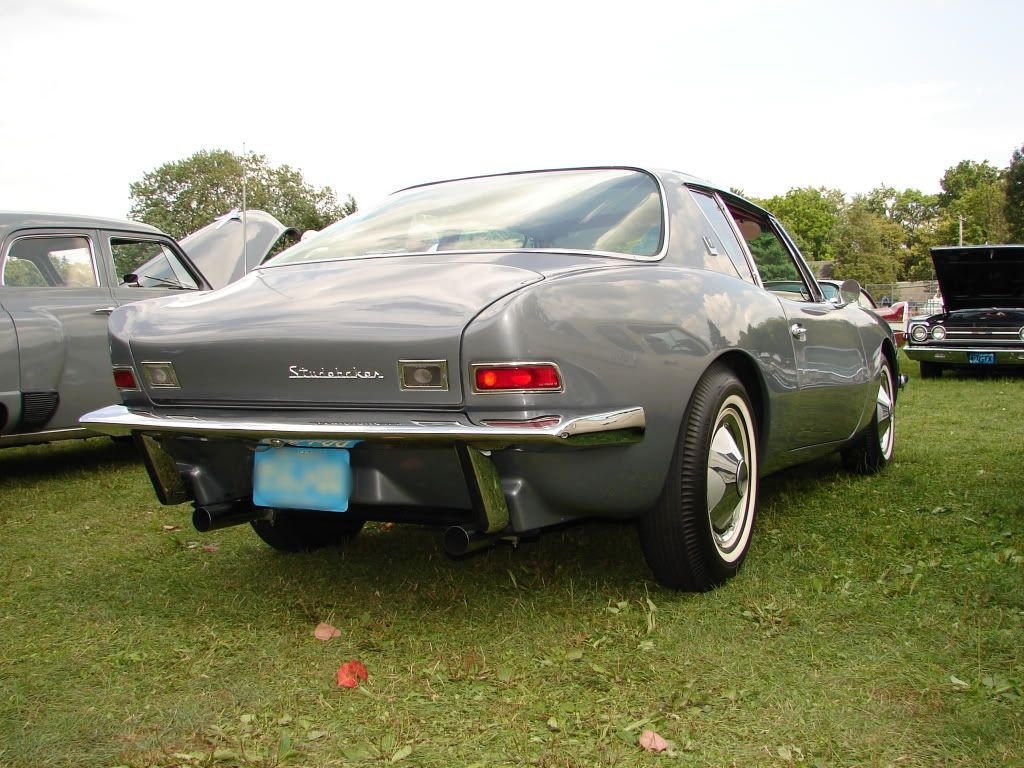

    Here is a beautiful '63 that was was at Das Awkscht Fest in 2012.
    Many people today prefer radials and many of those go with 205/75R/15. Example of such. With the radials you want to make sure the wheels are in flawless shape - radial tires do much more flexing at the sidewall than the original tires do and have caused some wheels to fail.

              Does anyone make them in Avanti size with the old-fashioned ridged sidewalls and correct ww width as seen in the top photo? And can radials be made to look like that? "With the radials you want to make sure the wheels are in flawless shape - radial tires do much more flexing at the sidewall than the original tires do and have caused some wheels to fail." I seen that advise countless times here...but I've never heard the same warning concerning Fords/GM/MOPARS of the period. Were Studebaker wheels somehow different? And is it really a safety issue for normal driving...(I'm not planning a trip to the salt flats anytime).
