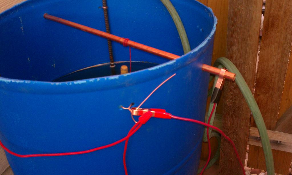

    Started with a 55 gallon plastic drum to replace my 36 gallon Christmas storage tub. Much more substantial and even has a drain. Inside the garage may be OK for a demo in a half full 5 gallon bucket... but this hydrogen thing I've been ignoring might go booooom inside with 30-40 gallon tank and a good power supply!
    For power supply this time I started with an unused computer power supply. Grounded out the green load wire and grouped other wires by color/voltage to a handy bar.

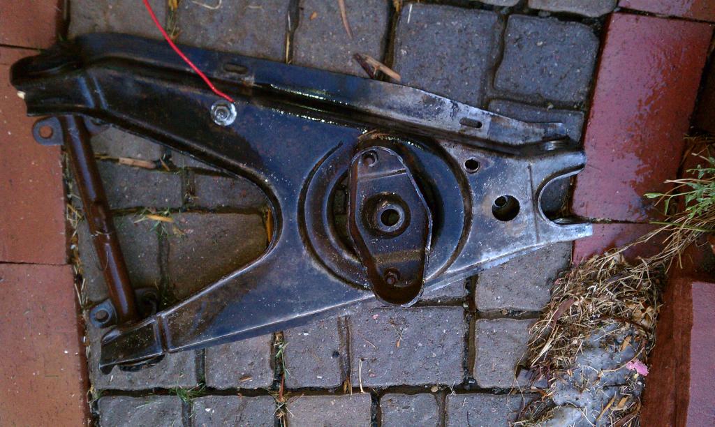

    Pictures below show the result after a lower control arm was in the tank 5 to 10 minutes. The brown foam around the rebar is rust that has already migrated from the part. Power supply is from the 12V 16 Amp lug.
    1 table spoon washing soda per gallon of water.
    Part on the negative, rebar on the positive.
    4 hours to overnight in the tank then brush/rinse off remaining crud
    Spray with OSPHO to prevent flash rust until you can get around to painting party.
    After the needle scaler this is an easy way to get clean down to ready to paint condition.

        Total cost for this setup--- Plastic Barrel free, hand full of wire nuts and left over wire and copper pipe, 500 Watt power supply from a junk computer, a $7 patch bar from home depot and part of a box of washing soda at $5 a box.

              One piece overnight with the new set up and I'm elated with the results... think it did a better job... now to see how the power supply lasts... Passed test #1 so now I'll hang the PS on a wall inside and run a wire out to the tank.
              No before and after on this part but here is it's left side twin as it came off the car and this part after about 10 hours in the tank. Note that the pivot bar was isolated from the main part with the rubber bushings and did not clean. I should have run a lead to it.
