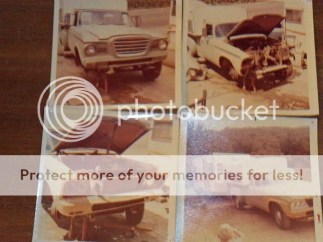

                          As per my original post here are 4 pictures of my 60 being converted to a 64 using the front sheet metal from a 64 Daytona hardtop. still looking for one of it painted and done.
                          Candbstudebakers
                          Castro Valley,
                          California
