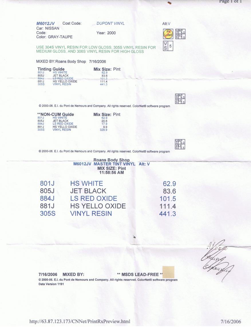

        It's my understanding Loma Gray was the standard interior color for all '53 models regardless of interior trim or exterior color.
Name:	Loma Grey paint.jpg
          According to Bridges' book, the one exception was the Bombay Red cars trimmed with Flax colored vinyl---in those instances "all metal items. . .were painted Monterey Beige."
          Which probably answers my own question once I read it again. But if the Loma Gray doesn't match it very well I'm not sure I want to go that direction. . .
