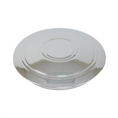

          Center cap for $11.41
          Free Shipping - Cragar Wheel Center Caps with qualifying orders of $109. Shop Wheel Center Caps at Summit Racing.

            It looks like the center caps are retained differently from Studebaker dog-dish caps; that is, they are retained by the Chevy external (to the hub of the cap) "lugs," rather than the external "nubs" of most other stamped wheels.
            Note there are no "nubs" around the outside of this Chevy Rally Wheel's center section, on which the center cap or dog-dish hub cap could be snapped. The center cap must have its own nubs to snap in the groove inside this wheel's center section, not nubs around the outside of the center section:
            'Looks like a good alternative, for sure, as long as one does not want to use Studebaker-specific dog-dish hub caps. Good find. BP
                          Note there are no "nubs" around the outside of this Chevy Rally Wheel's center section, on which the center cap or dog-dish hub cap could be snapped. The center cap must have its own nubs to snap in the groove inside this wheel's center section, not nubs around the outside of the center section: BP
                          The nubs are on the inside of the raised ring in the middle of the wheel. Different but it works.
                            You know, that looks like a Lazy "S" vinyl logo could be easily applied in the center ring...
                              Right, John. As I said, no nubs on the outside of the center hump; inside only. The illustrated wheel does have inside nubs; other GM wheels I've seen have an entire ring inside the center hump.
                              The principle is similar: With this arrangement, the hub cap must compress a little to get within the inside nubs, as opposed to the alternate arrangement, when the cap has to stretch a little to get over the outside nubs. BP
