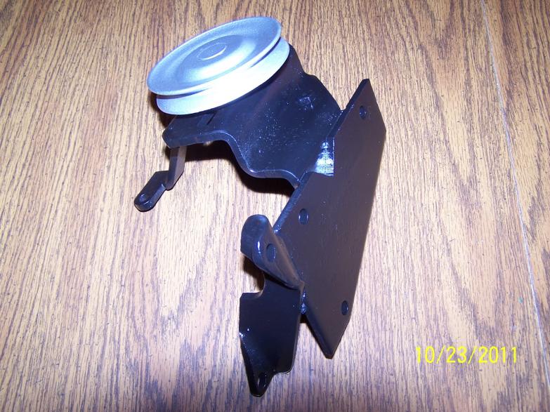

              Another quick question- my car has dealer-installed A/C. I read some tech articles from Stude folks on installing A/C on a Lark. I have a complete system with the EXCEPTION of the idler pulley and the belt for the A/C compressor. Mechanic says system is good to go so long as we can make an acceptable idler pulley installation. Using the advice from the SDC tech article, I told my mechanic that an 80's Japanese idler pulley might work, and he found one that he will have to shim, but he thinks will work. Can anyone give me any specs on the "stock" idler pulley and any information about the correct belt, including a part number? If I need to move this to TECH, I understand (sorry moderator).

                I don't have the dimensions of the original, but does that make any difference at this point? If the mechanic has the 80s Japanese idler he thinks will work, just use it. Once he has it installed and fitted where he wants it, run a rope around the pulleys as you would a fan belt and use that rope's length as a guide to shop for a belt, since the "alternate" idler will likely produce a different belt length requirement than would an original pulley. Measure across the top of one pulley to get the belt width you need.

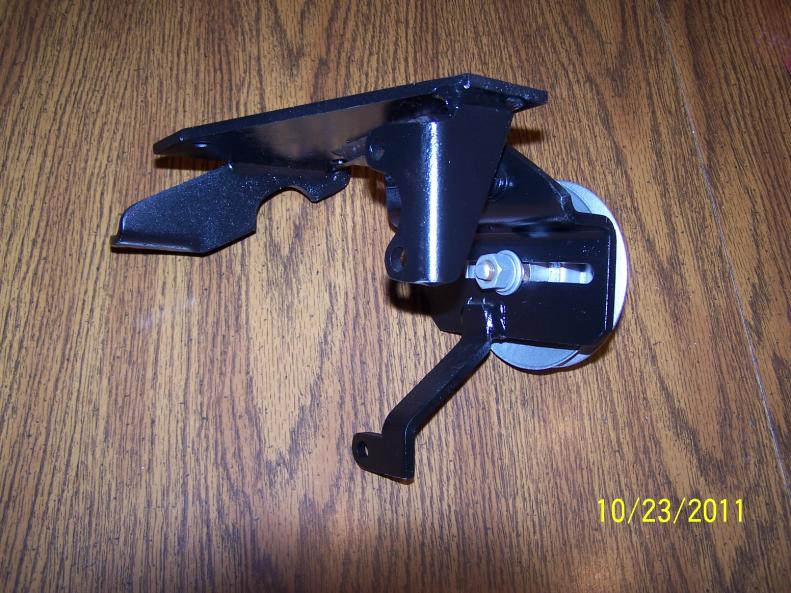

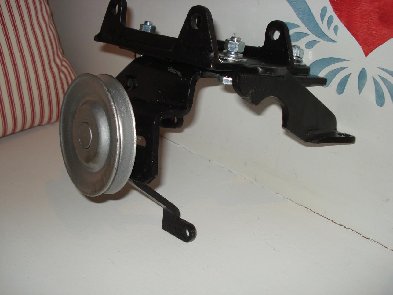

                      I know that that Bob Helm in TX sells idler pullies for AC installs. I do not know if he sells the ones specific for 65-66 McKennon engined (283) cars. Look in the TW classified for his ad for AC'ing your Studebaker. I just installed it on my 64 Cruiser and it works great. The belt number I used is Gates XL 9520 13A1320 ( 1/2" X 52-3/8"). I have attached a picture of the idler pulley used on the Studebaker V8.
