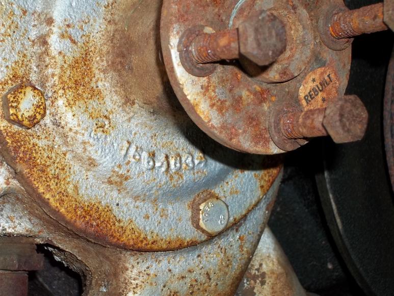

              Hey again SDC, I have a pic of what my motor looks like, trying to get the fan installed correctly.
              Please take a look at the pics and let me know if I need anything esle. (got 4 bolts sitting there)
              (will have fan blade and pulley soon, fan belt, got it) I was tol d there is no fan clutch on a 60 Hawk, no a/c.
                First of all, that very old "Rebuilt" Water Pump either will leak or is about to, there are new Pumps for not much more than a rebuilt nowdays. Also, some models have a 3/4" fan spacer as well, you will have to check Radiator clearance when the Fan shows up.
                The clearance should not be much over 1 inch or less at the closest point, usually the bottom.
                  The pulley goes on first?
                  then the (spacer) fan?
                    Yes. Pulley, then spacer, then fan.
