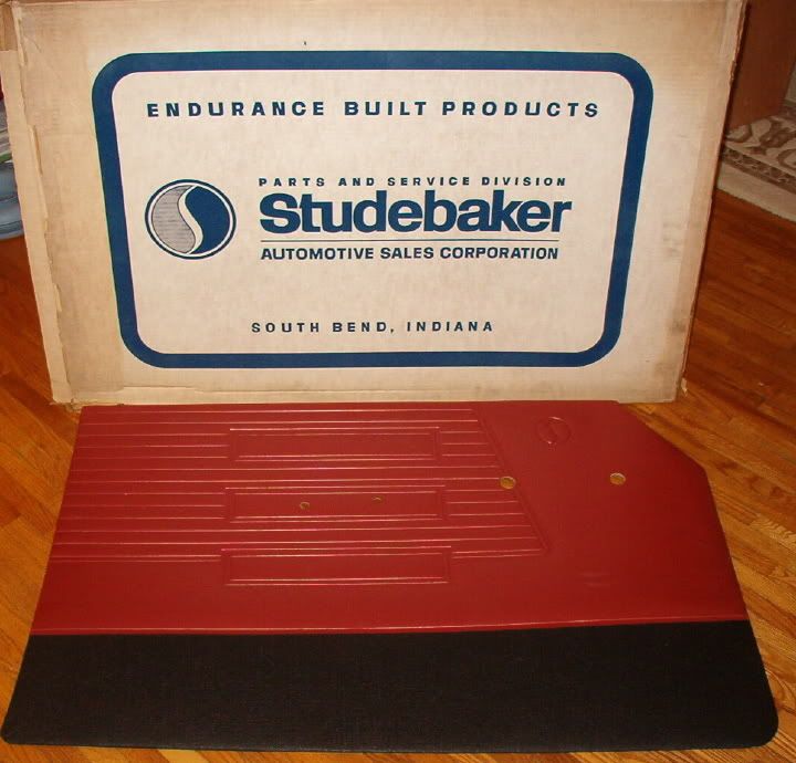

                    Is this the color that you are looking for?

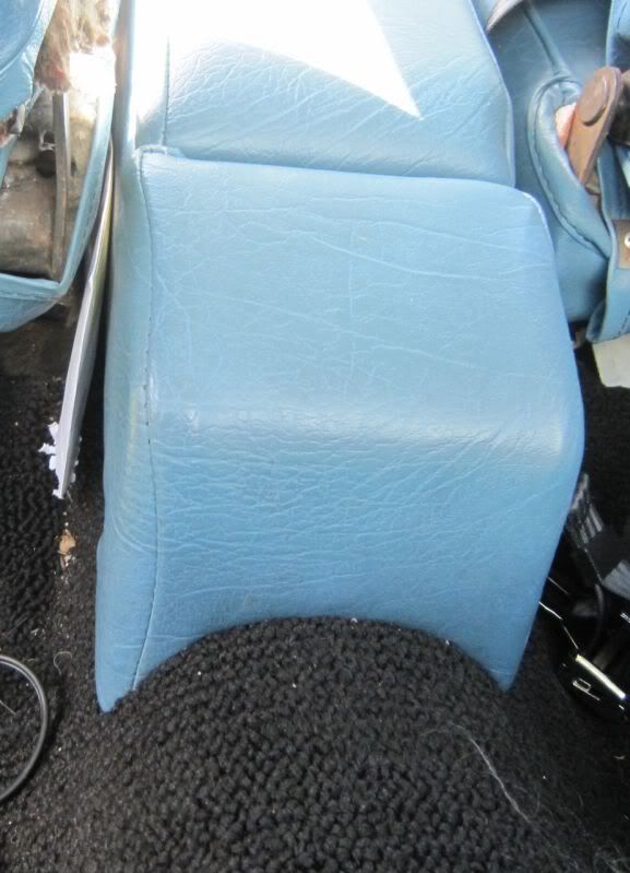

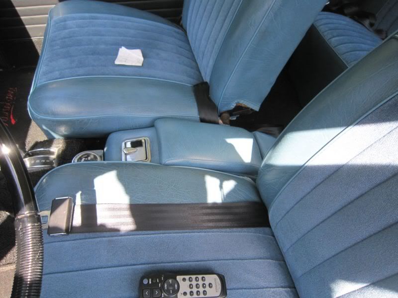

                      Not sure where this center console came from, but I had it re-covered with JP's kit and attached it with velcro strips on the bottom (hook side to grab the carpet)
                        Yes nick, that is the color i am looking for
                        thanks
