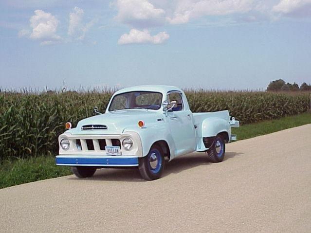

                          Here is my Daughters '57 Transtar with an Avanti engine & transmission in it. It was almost a "junker" when she purchased it.
                          The complete story is in TURNING WHEELS September 2002 issue on page 7 (with a photo on the back cover)

                            Sharp-lookin' machine! I need to get some fresh paint on Pete this summer!
