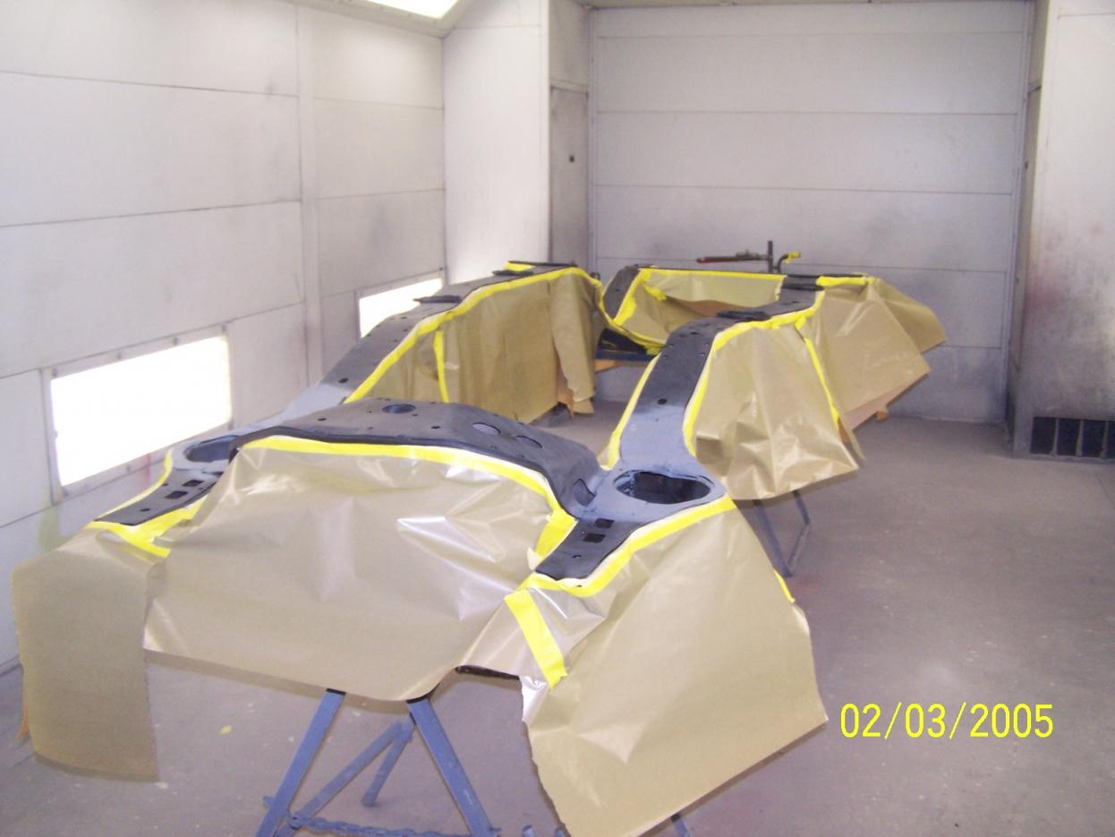

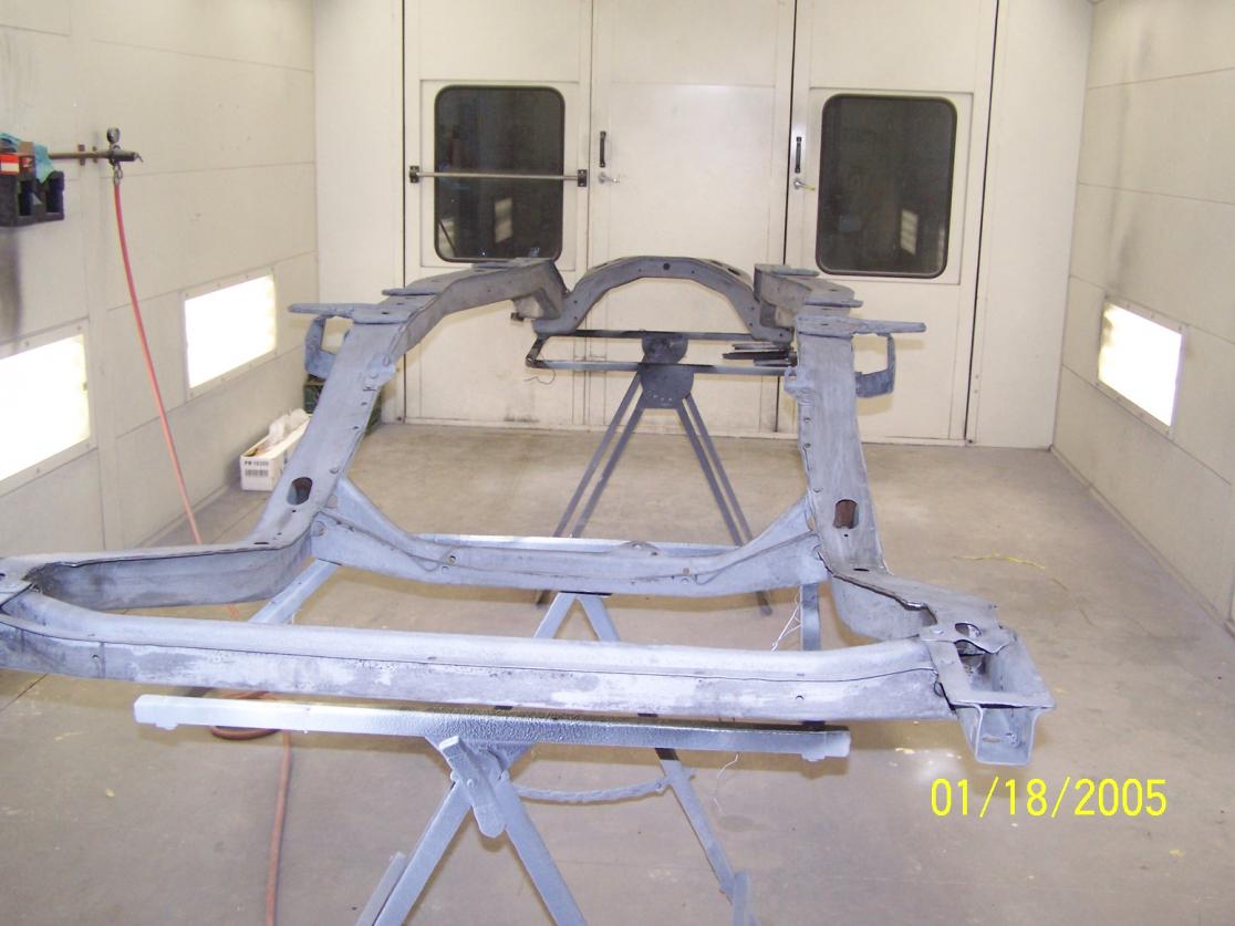

    Frame went to get sand blasted, when it returned we went ahead and sealed it with DP90, and top coated it with Acrylic Enamel. Once painted, we began resembling the front suspension and brakes. In the coming weeks we will assemble the rear suspension, install the brake and fuel lines, and the motor and transmission.

    more pictures sorry a couple got mixed in, but they are fixed now

        Very nice work. The 4th. Pic in the first group, and the last pic in the second group of some Disc. Brake Rear Suspension? must be a Brand X Pic that got mixed up twice with your Stude. Pics!
          yes they did sorry about that!
