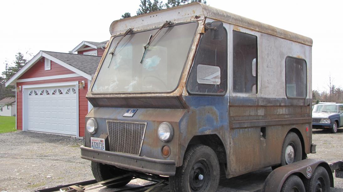

    Thinking of putting the top 4 or 5 feet of a zip van on one of my weasels for an elk hunting rig. Looks like it would fit fairly well.

          Here are some Zip Van Pics as requested:
ID:	1671752Click image for larger version
ID:	1671751Click image for larger version
ID:	1671750Click image for larger version
            Here are some more:
ID:	1671753 Click image for larger version

                IIRC, a Zip Van is 144 inches long.
                  Hey rich looking at the pic with the body lifted. You'd have to cut the lower body off under the cross supports under the cargo floor. How far down on the outside of the body is that roughly.

                    Sorry, someone else will have to answer that one. I do not have access to one at this time. The 3 Vans that we worked on, are customer Vehicles, not mine.
                      Boy looks like you could cut a straight line starting at the flat spot on top of front wheel well going all the way around the truck.

                          The floor is the main structure, about a foot and a half up, is another 'perimeter' type stucture. It would be very difficult, not impossible to cut it off and have it not fold up like a cardboard box. You need a shot looking in, from the back. The zip van has a pretty flat floor, the driver seat may end up really close to the steering, but you may be using weasel controls??
                          If you removed the overhang around it, it may just set onto the weasel. (also a pretty flat floor) Then again, the upper body may sit onto the weasels body if the WIDTHS are even close. The rear door is sectioned like a garage door, you have to remove at least part if it. Cool concept, lots of work to do.
