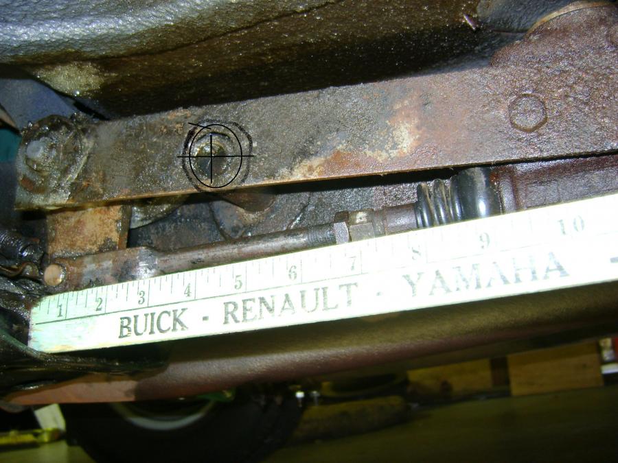

    Looking for brake pedal master cylinder rod and bracket for 57 clipper parts book lists 55 thru 57 the same to replace power brake with standard brakes. Had my Hydrovac rebuilt and still do not like the feel of brakes my brothers President with standard brakes is easier to use than my power brakes all other parts are the same tired messing with power brakes.

          Found the part I needed took some pics of power brake pedal and standard setup for easy id of parts longer one is standard brake unit which mounts closer to the rear of car power unit setup mounts on its own seperate mount bolted to chassis from top. The picture under car shows the mounting of power setup the one with cross marked is the mounting for manual system
