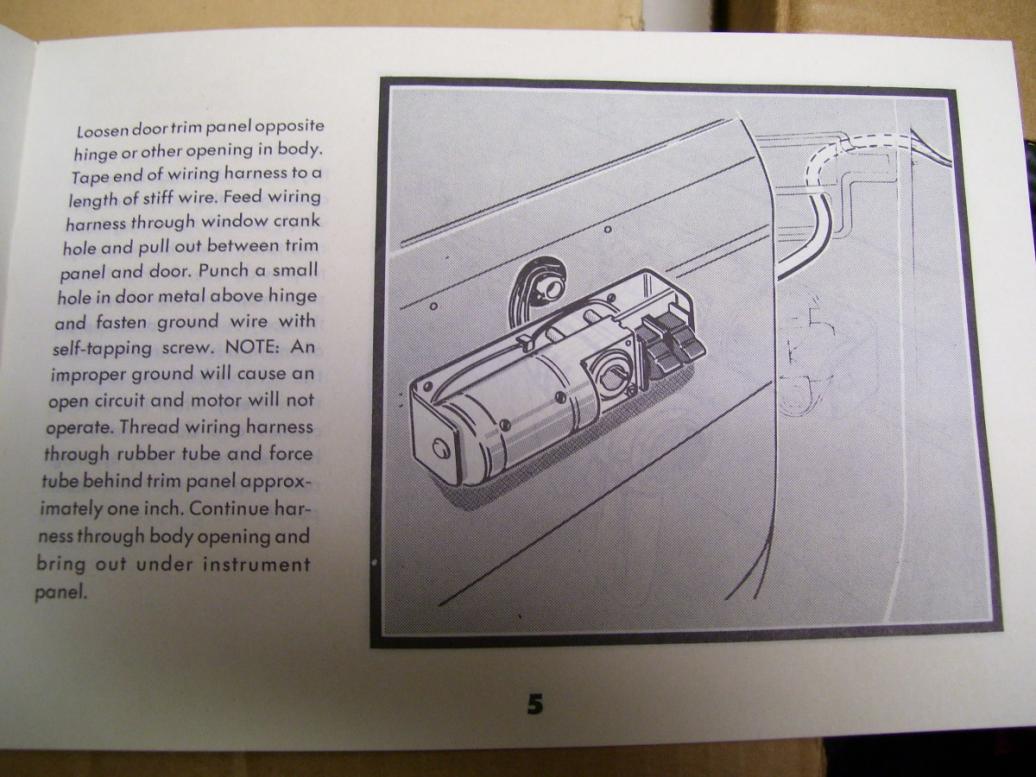

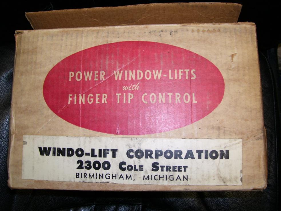

        I found my power window kit tonight. It's from Windo-Lift Corporation. On the instructions it has a silver label that covers up where it said AMT.
        There's various adapters but no mention of Studebaker in the instructions. Maybe one of them fits.
        Here's a few pictures.
        • #19
          A few pictures of the instructions.
          • #20
            The rest.......
