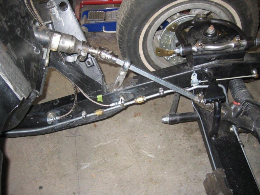

                  Bob, you should have some bracing on that lower control arm mount, that long tube at the rear needs it.
                  They should have sent you some gusset plates with the kit.
                  If not you need to make some.
                  • #24
                    Thanks johnrod,
                    Will look into that tomorrow...just got back from skiing in the Sierra. Thanks for the advice, It is Always Welcome.
                    Bob
                    • #25
                      This is what it looks like. Dusty
                      Dusty Taylor
                      • #26
                        Bob, Check out this thread, some good ideas/advice. I'm going to be installing another brace on my own susp after reading this thread.
                        John
