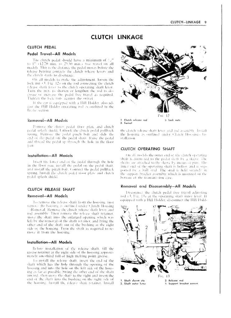

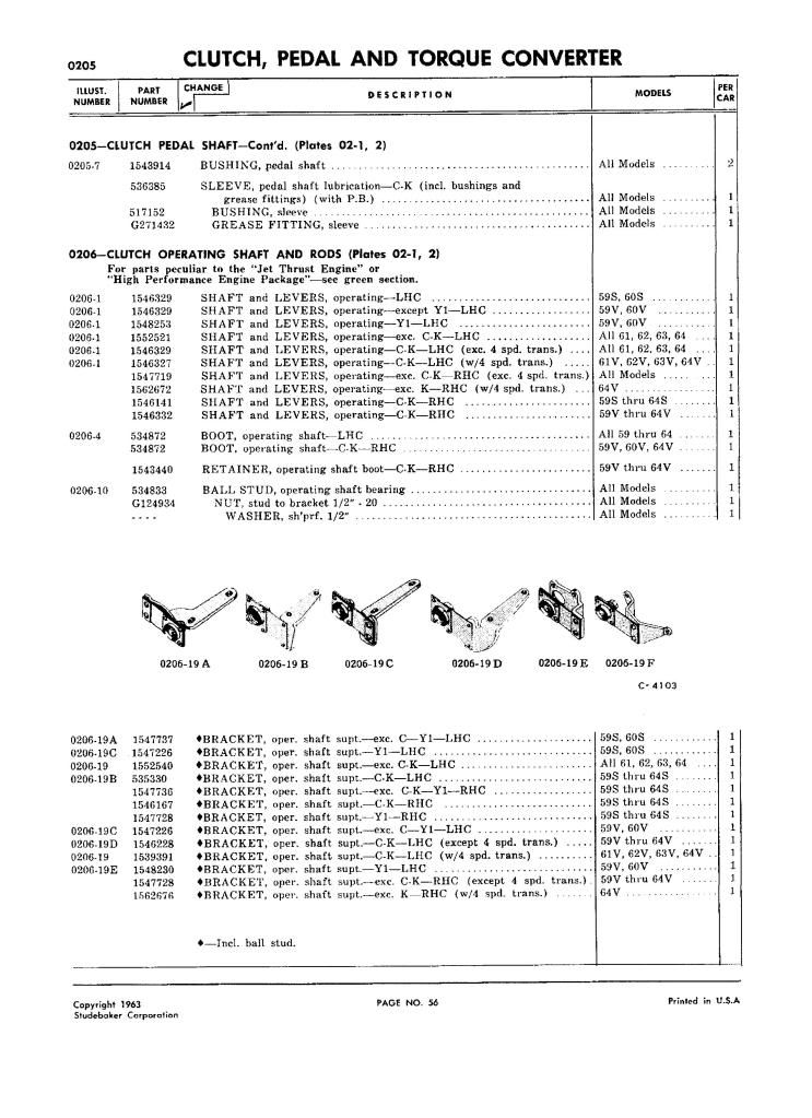

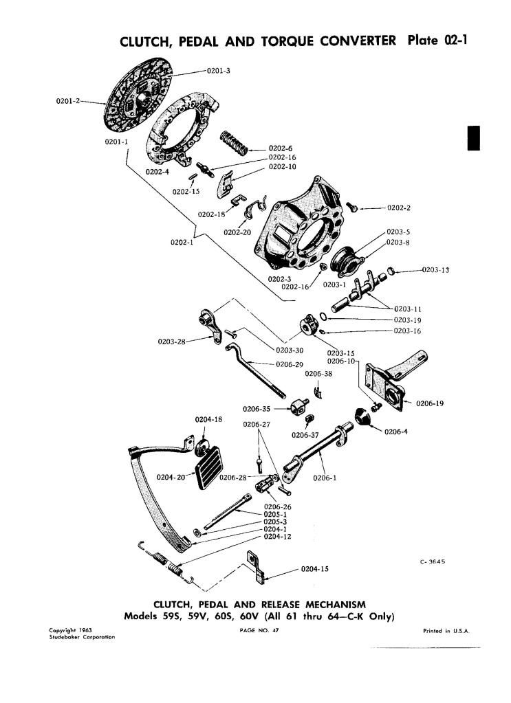

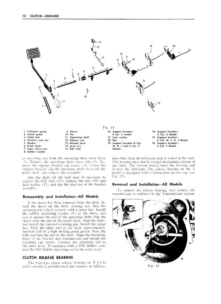

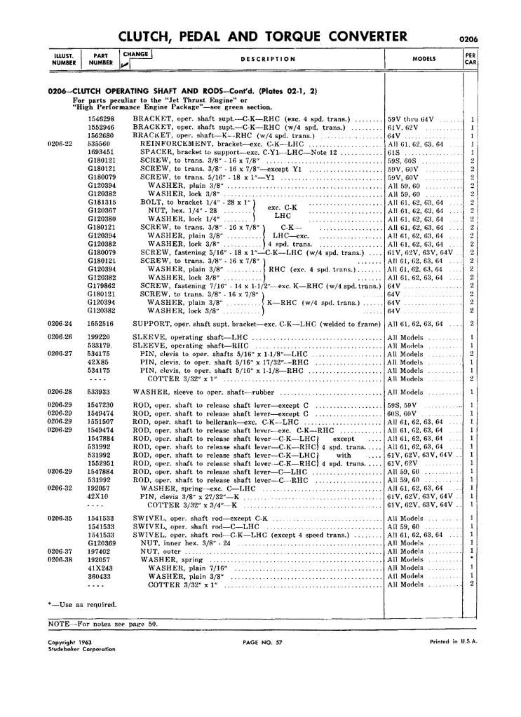

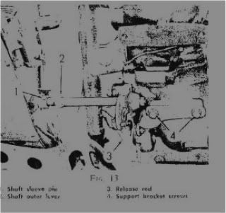

          C & K Clutch Linkage
          Here is some info for you from both the '59-'64 Shop Manual & the Chassis Parts Catalog:
          It's a 1539391 Bracket, it appears that they forgot to picture code the part Number! It should have been 19F.
          Sorry, that is the best I could do in one hour of saving from the CD to my Computer, Printing, Scanning, Saving to Photobucket, Posting to Forum.

              SilverHawk, if you look back at the pages that were posted, you'll see that there are at least 6 different styles of shaft support brackets. If you have any one of those, its not difficult to make it work on your application. Grind off the rivets that hold the flexible steel plate with the shaft support on it, then make your own 1/4 inch steel brace to mount under your transmission. Then you can locate it where you need it. Just bolt the shaft support to the brace you made. I've had to make two of these. One for a T-85 3 speed and one for a T-10 4 speed. Good luck.

                      @Jamie: As of right now I have 0 pieces to this puzzle other than the T-10 you saw at dad's house. It came from a lark so not much of the linkage will be usefull. I am trying to work a deal with the guy for both cars but so far no success. I'm going to give him a call tomorrow to offer for just the tranny and clutch linkages from the Hawk so we both get what we really need. After that I should have a better idea of what I lack. But looking at the pictures from the manual I'm sure I can get one made up at work. We have a full sheet metal shop and that bracket doesn't look like it would be any bigger than 1/4" thick material bent into top hat shape to bolt to the transmission and catch the end of the shaft. I'll keep you up to date on the progress of the deal.
