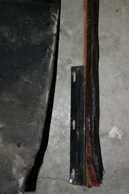

    When I bought my "62 Lark the headliner was removed, and the previous owner gave me parts that he said were headliner hardware. The picture below is a part that I got 4 of. (Ignore the round thing above it, it's a reflection off my counter top). Each part is the same; about 8" long and 1" wide. You can't see it in the picture, but on one long end it is bent 90 degrees up about 1/8" high. I read the workshop manual and read a headliner install from this forum, but can't figure out what these might be for. I think they must be for something else. Any help will be appreciated. Thanks.

    I didn't see any piece like that from the headliner...........but it looks very similar to a piece that is located a little lower than your shoulder (when you sit in the car's seat) that holds the windlace, rear passenger bottom panel, and the headliner piece that makes it's way down the B pillar, I'll check my parts stash to see if this piece is indeed what I think it is.

      Thanks a lot. The windlace was also removed, but the interior panels are on the car.
        Stu is hot on the case.. the metal piece attaches to heavy cardboard ( with spray adhesive) which has a small piece of headliner material (also spray adhesive) to cover the b pillar. It attaches to the pillar itself and the cardboard covered part folds over to trim out the pillar. The rear window bezel holds the "loose" side in place..hope this helps..kinda hard to explain..

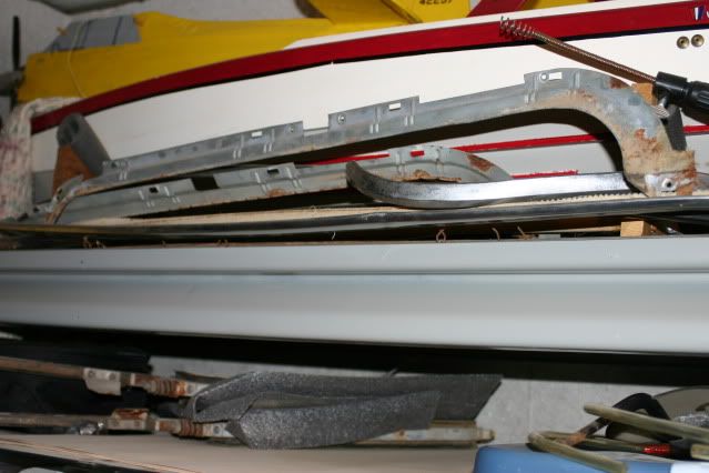

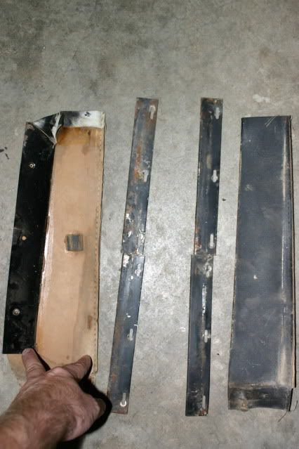

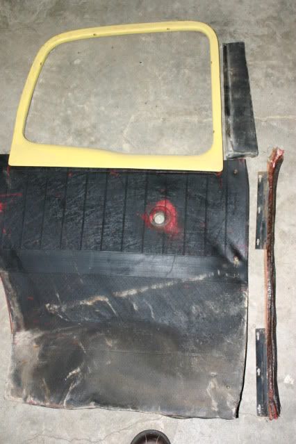

            Here's the pieces you need, 2 metal strips overlapped with interior material, PLUS 4 windlace affixing strips (2 each side) This is what
            you posted a picture of.

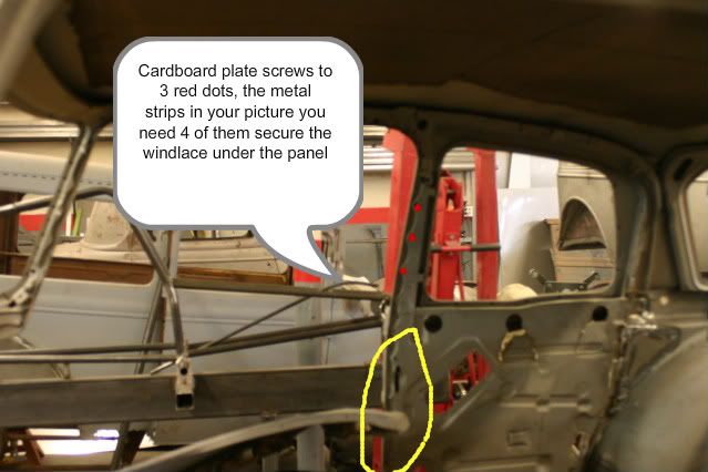

            Approximate location of each of the above pictured items, and then of cource your window trim (if you have a 2 dr.) Yellow area is where the metal strips go.
            This is the piece that attaches over the driverside door, and the headliner in conjuction with the bows,
            wrap around this piece, and are held into place with triangular barbs, (hand saw teeth ON the piece itself)
            The handsaw teeth you find all round your door----those crip onto the windlace to help hold into place. Not sure your
            experience so hopefully I didn't step on any of your toes. : )
            Hope all this helps, people talk about having hard to find sheet metal, but these pieces are the gems that get tossed.

                    Just to hold it into place, Metal strips go top and bottom, and the Interior panel screws (3 I think or was it 4) right into the top of the top one and bottom of the bottom one. Along with a couple screws holding the metal strips themselves.
