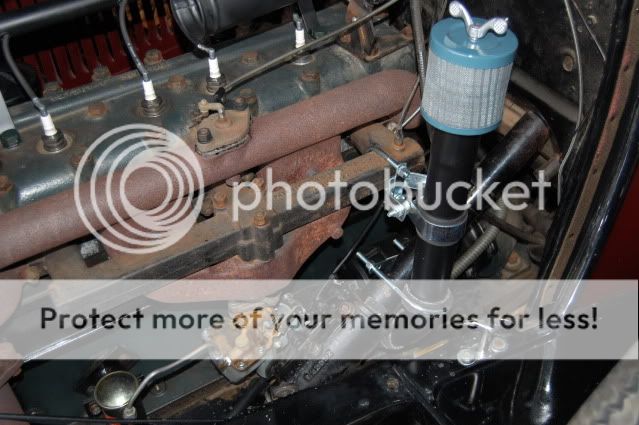

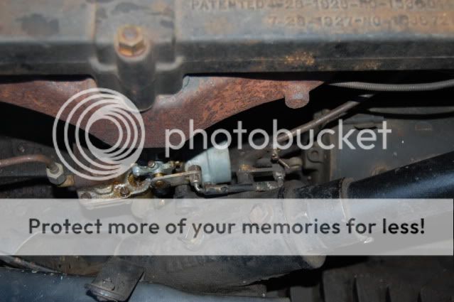

So, after several responses, but really no leads I determined a) this wasn't the original carb (hence the really, really tight fit at the air intake, and b) I was going to have to fabricate something.
I used a 90 degree silcone elbow (from a high performance parts website) off the intake to a section of muffler pipe I had bent in to a sweeping L shape that goes straight up to an air cleaner I found on a Model A/T parts website. Painted the pipe and clamped assembly as you can see to the manifold. All works really well:
