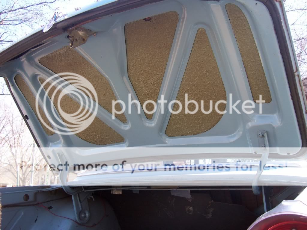

                    Here is how most original U.S. built Lark trunk lids looked, with the spray-on insulation:
