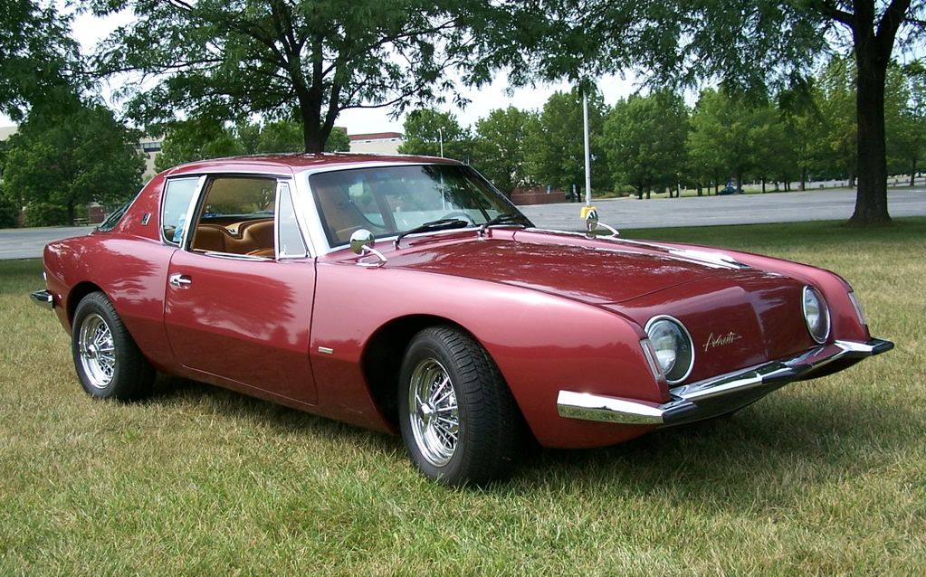

                                Here it is driving by at the speed limit:
                                And then just a cruise by:
                                From this thread :
