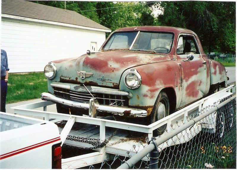

    Notice the front valance behind the bumper. After it was sand blasted it was full of holes and no replacement to be found. I cut it to make it 3/16 inch smaller and welded it on. Covered the in side with POR-15 and the outside with POR-15 and fiberglass cloth. Sprayed it with TY-Coat and fiber glassed it sanded it down and put 3-M Dyna- Glass where the glass met the metal. So far it is holding up.
