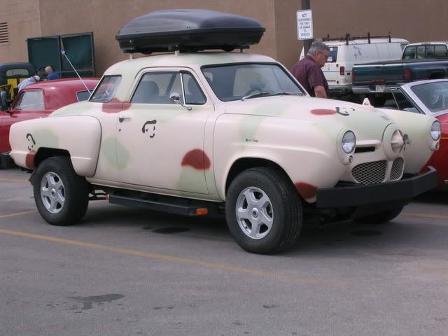

            Someone on here must have a picture of the one in Southern California that the couple put on an S-10 (Blazer?) 4x4 frame. Yes, it sits high. Has a camo paint job and a roof rack. They used to drive it a lot. Anyone?

              That would be Mimi & Bob Halgren
                Owned and built by our SDC President and her husband. I believe it's all Tralblazer underneath including the (modified) dash. Beautiful work []

                  Owned and built by our SDC President and her husband. I believe it's all Tralblazer underneath including the (modified) dash. Beautiful work [] Dick Steinkamp
                  Indeed~ it is (was) a TrailBlazer. Seen it once or twice I have...
