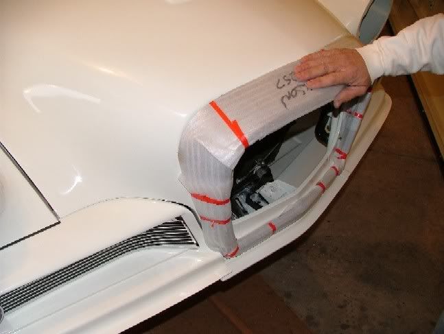

    This is where we are with the front end...If I mask to the center of the mounting holes and paint everything 'inside' flat black, I assume this will be the correct way to do it... not sure about the 'air scoop part'...

    Yes, behind the grill about halfway through the mounting holes on the inside.

        '64 grill meshes are hard to find, the '63 can be masked and painted so that only a very close look will tell the difference. I have one like that I will sell if you want. I checked Fred Foxes article in 10/92 TW to confirm my memory about painting the air scoop. He says the 'inner half' of the scoop gets painted, I agree and remember it as basically all of the horizontal surfaces. Does that help?

                Are you just holding the grille shell up to the hood to see where to paint? If not, I recommend removing, rather than masking, the grille shell before painting.

                    Yep, just holding it in place to get an idea of what should be painted...JP suggested masking the area to the holes which is the best sounding idea to me..
