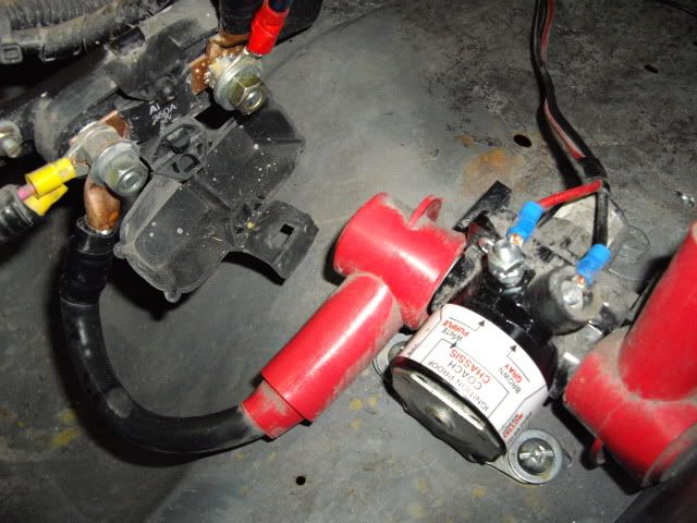

          When I rear mounted the battery in the 54K, I wanted to be sure the Main Power line was protected.
          Here's a shot of the High amp fuse from West Marine and the electric power diconnect from a Travel Trailer dealer. The fuses are available in a wide variety of amps.
          Power goes from battery to fuse to disconnect along the frame in plastic conduit to the starter.
          Bob
