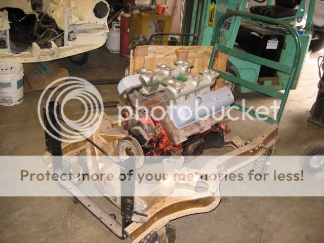

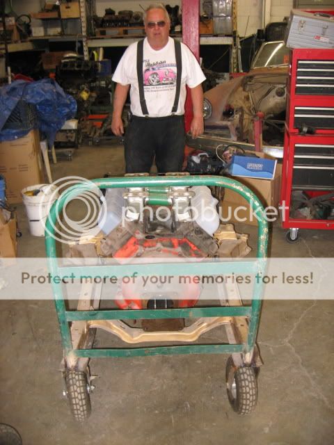

      I was at Bob Peterson's today. I showed him how to upload pictures to Photobucket and then post the pictures here. I think I created a monster and I apologize in advance to the members for doing so [B)] [:0]
      Anyway, I couldn't resist taking a pic of Bob's engine stand for this thread...
      It's pretty neat. Front of a Stude frame on wheels with a push bar.

        I was at Bob Peterson's today. I couldn't resist taking a pic of Bob's engine stand for this thread...
        OK now, that's the best one yet! Great work, Bob- not to primitive, not too fancy, and just the right size!
        I wonder if there's a better choice for wheels out there? Something that would roll on gravel easily, but not TOO big...
        Thanks guys, I'm gonna copy that one!

            I like that one, may build one myself for newly rebuilt engine testing before installation and add the gage panel that Nimesh has on the other one shown. However, it does take quite a bit more space up so I would have to store it outside when not in use.

              The half ton truck frames are more space-friendly than the car frames. And one thing we aging geezers need to consider is how much time we wanna spend on our failing knees or bending over with our aching backs. I'm only sorry I didn't put longer legs on mine.
              Yeah gord, I've used slime for years. I guess it just goes against the grain to buy new tires and have to institute repair measures before I ever use them.[8]
              Those pneumatic tires ARE nice tho! That body rotisserie that Allen Barth swindled me out of, we rolled that baby - WITH the biz coupe body on it - right across the uneven yard and right up into his trailer. Wouldn't have happened like that with solid wheels.[^]

                  Dick, thanks for posting the pics of Bob's stand, that one's pretty slick. I might cut the front frame off my Daytona Wreck and make one similar.

                    This frame engine stand does take up its share of space and the cheap tires do go flat so it does have its draw back, but is is safe, we are working on a panel for switch and some gauges ect. funny no one noticed the gas station sitting on top of my engine!!!
