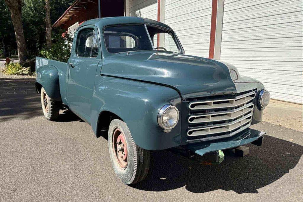

    I just acquired this 1949 2R10-22. It is a frame off restoration 95% done, but restorer passed. Its been sitting for 10 years. Rebuilt engine, transmission, rear. I'm new with Studebaker, and so I've got a ton of questions. But also looking for inspiration. Any suggestions appreciated.
    I am thinking that this restoration is accurate and i should do my best to keep it original. I don't want to commit blasphemy, but how far does that go...do I look for original battery cables or is that getting nuts?

    Wheels.....I understand these are split ring. I saw pics of some trucks that had wheels weren't as bulky as the Budds (I think they're fugly) with baby moon hubcaps that I thought looked classy. I have been googling for many hours and can't find anything at any supplier. Again and like everything else, should i stick with split ring for originality, or pursue other options. If I stick with split ring, is it ok to put on radials (with a tube and what size?).

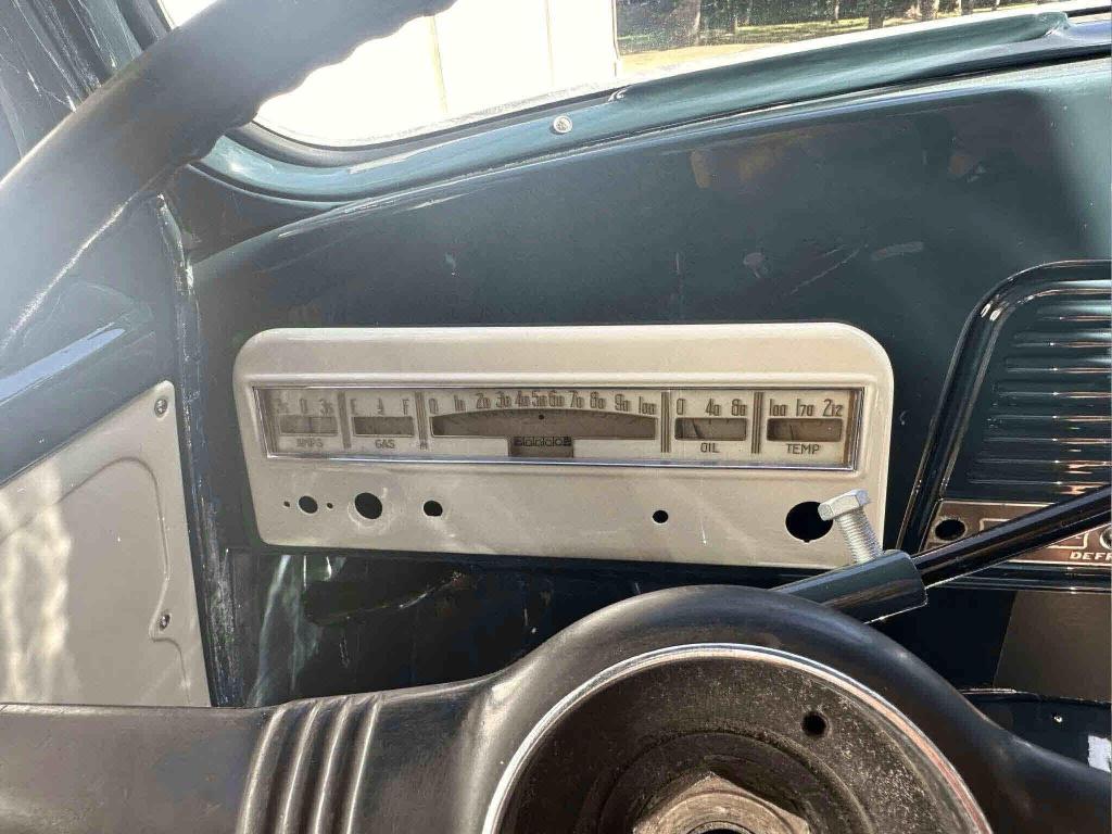

    There is no wiring. I'll assume there is a fusebox (truck is in transit...won't have it f a week). I'll assume a horn headlight and taillight, dashlights' maybe someday signals and fogs, oil temp and gas gauges maybe a dome light. I don't think I'll need to buy a harness, but 12 ga or 14 ga, ? What is the concensus on switching to 12 volt? I was thinking to keep it 6 and use led bulbs, or maybe a converter to 12v just for bulbs and a radio

      Very cool, nice truck. I think you are mostly on the right track. Except 1 critical thing - I would highly encourage you to keep those Budd wheels. Me and a lot of other Stude truck guys will tell you they are one of the unique things that make those 3/4 ton trucks really cool and give them their unique honest work truck character. Those are very cool old wheels. And if they are in good solid shape, ie not rusted up, they can be serviced and are safe to use. I use to have a '53 2R11 and those wheels are really makes those trucks. Just my opinion of course. It's your truck and you should do as you like best. But if you do take those wheels off and don't ever want to reuse them or keep them around for the next owner maybe. Maybe sure to try to get them to somebody else who can use and will want to use them. They are getting pretty hard to find in good shape.

      Definitely buy a parts book and shop manual, between the two you can see what goes where, and what you may need! If you build your own wiring harness (wiring diagram in the shop manual) I recommend buying a simple fuse panel from Summit Racing; while not original, it can be handy to use modern type fuses for all your lights and accessories.
        Stephen Allen I think now is selling new wiring harnesses. But I don't know if for the 2R10 trucks yet or not. I would highly recommend getting one of them if so though if are, will same a lot of time and headache figuring things out, especially if this is your first go around. Matt on here may chime in if he sees this. But just call them, they will be more than glad to help.

          As far as "original vs modified", it's all in what you want. In stock form, a 2R10 3/4 ton with the 85 HP Champion Six is a 45-50 MPH vehicle. Only you can decide if you want to enjoy the truck as it was built, or turn it into something with different driving characteristics.
          The wheels - There is no other wheel that will bolt on and fit. If you want to ditch the Budd wheels with the lock ring, your only option is to have wheels custom made. If you go that route, there are plenty of guys out there that will buy your original wheels.
          Mike, thanks for the plug. The website hasn't been updated with all of our new harnesses yet but we do have factory-correct 2R truck wiring in stock right now.
          These trucks didn't have a fuse box. You'll find a circuit breaker in a few places but that's about it.

            I'm accepting the wheels. Will sandblast /powder coat. Wonderinfg about tire type and size. Should I go w bias ply (i didn't even think they were still avail.....what size is 7.00 ft and 7.50 rear too much or not enough. or should I go w radials?

          The 2R trucks were in production for 5.5 years, and there were many running changes. These were documented in series of articles by Fred Fox in the SDC's magazine. Interior colors were one of those changes. I can probably provide you with the dates of those magazines later this week. There was no fuse block on 2R trucks. Each circuit got its own fuse.​
