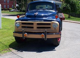

      Click image for larger version  Name:	54 Flatbed Dump3.jpg Views:	0 Size:	136.1 KB ID:	2066673
      This is a '54 3R Big Truck so it has the 232 V8 hence the V8 hood ornament.

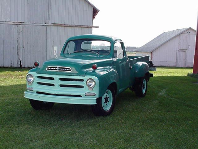

      Click image for larger version  Name:	55 E5 O.D. Red.jpg Views:	0 Size:	97.0 KB ID:	2066674
      Here is a '55 "E"

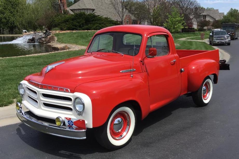

      Click image for larger version  Name:	56Transtar,075TonGreen3.jpg Views:	0 Size:	44.1 KB ID:	2066675
      Lastly a '56 2E
