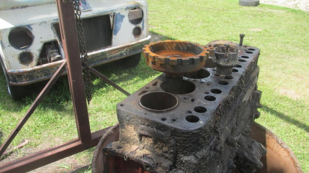

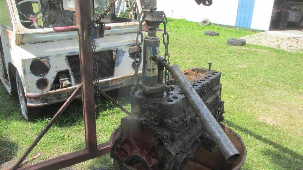

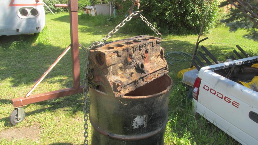

OK, I took some pics, will try to attach them. I got the last piston out, but it was a struggle, and the piston is damaged. I made a rig to use a bottle jack to push down on the piston. Cranked on the jack until the cup for the chains began to bend. Left it overnight, still stuck. Took the jack away, and placed the ring gear from a busted transmission planetary on the 3" pipe, and bashed with a ten-pound sledge. It moved. Finally got it driven down until the piston skirt reached the main bearing boss. Ran flex hone in cylinder. Could not drive piston back using 2X4 and 2-pound hammer. But a length of steel angle and the ten-pound sledge did drive it up and out, at the cost of breaking the wrist pin boss. Pics:
Very creative way to get a piston out. I have had good luck in the past using diesel fuel in rusty cylinders. Just keep filling the cylinder and wait.Takes days, but who is in a hurry.

Hi, Gord, sorry for your loss of the #6 piston; BTDTMT (Been There Done That Many Times).
Yes, diesel fuel is an inexpensive solvent for cylinders having pistons with stuck rings. Unfortunately, for those cylinders where the corrosion has progressed to the point of enlarging the piston/ring area to the point of an interference fit, it won't ever free up those; again BTDTMT breaking the piston to get it out.

Well, I have no immediate use for this engine. I will wash the pieces with solvent, and stash them for future reference. I have a fair number of OHV six pistons stashed already, so there may be a .30 over one in the bunch.Gord Richmond, within Weasel range of the Alberta Badlands
Spent a few hours on it today. Engine block scraped, and rinsed with solvent, ran the Flex-hone through the cylinders. There is a substantial ridge. I figure it would need an overbore to .050 or .060 to be any good. The only pistons on which the oversize stamps can be read are marked as .030, with one being maybe .040 OS. I will pressure-wash the block, and solvent-wash the pan, valve train, and internals, and stash it away. Anybody needs a core OHV six, let me know. It will be cheap. This one has full-skirt pistons in it.Gord Richmond, within Weasel range of the Alberta Badlands
