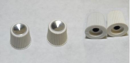

    A local fellow has 3-D printed a copy of a radio knob for a '63-64 Studebaker radio. Has anyone else done this?
    These knobs have a habit of yellowing over time, and also disintegrating (due to UV light?). This sample looks exact to my eyes, but of course, is too white.
    Comments?

    Looks good, if he can find a polished Stainless Steel Disc for it, and of course change it to off-white.
    Of course if one had a bad used one, the Disc could be saved and re-used.

        The local "3-D fellow" used numbered drill bits to push the SS disc and spring steel tension clip out of my knob. He had to do that in order to print the knobs.

          Just a knee-jerk observation, but without the stainless insert pressed into place, that new white knob looks just like a toothpaste cap!

          That looks great. Do you what type of 3d printing was used and the material? Probably the most common home 3d printing material used is PLA which also doesn't do well with UV exposure.
          Studebaker Avanti, Avanti, Radio Knobs NOS, Pair (nostalgicmotorcars.net)​ The original knobs are closer to white than what most of us have in our cars today, but still look slightly off white.
          Off-White PETG Filament – California Filament This material appears like it would be a better match to the other aged plastics in the cars and is also UV resistant.
          I've been meaning to print a fan switch delete for my 63 and I'd be willing to try the radio knobs also if they are willing to share the file.​

            I printed the knobs are printed with PETG. The color is slightly "whiter" than the original knobs, but I haven't found another PETG that is "off white".

            I may have to give that California Filament a try. I have also printed the '64 ribbed rocker switches, but they are a bit brighter white than I would like.

            A pair of knobs takes a total of 36 minutes on my Bambu P1S.

            The pic below is the pair of knobs that Nostalgic Motorcars has listed for sale. The color of the two knobs isn't exactly the same, so I would go with the lighter one (on left).
            --Dwight
