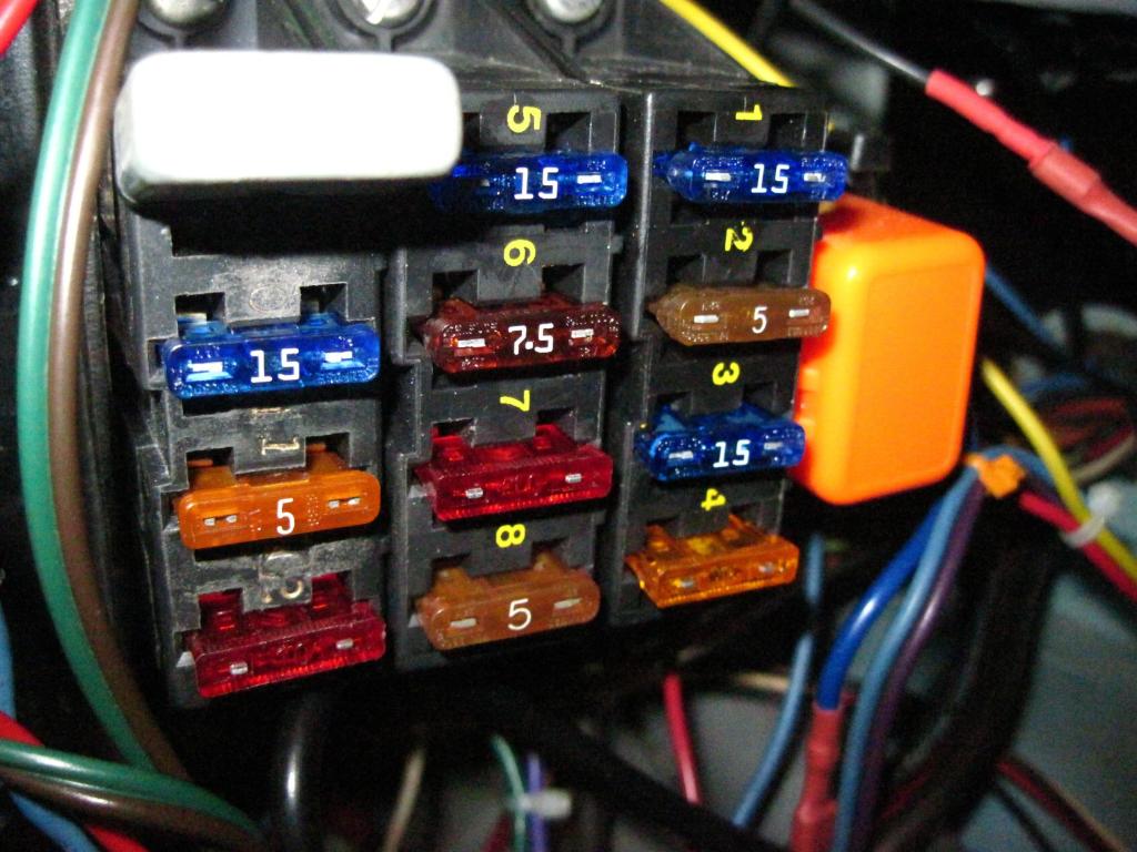

                        When I got my car almost every wire under the dash was red. With all the things I've changed I've replaced all those red wires. Along the way I did something similar but used three $5 generic four fuse blocks from "Auto Zone" that snap to one another. EVERY circuit now has its own fuse and it's mounted under the dash, on an aluminum tab, next to the steering column where you can easily get to it.
                        I also now have several circuits the car did not come with; AC, electric hood lift, Fog lights, electric fans, electric fuel pump...etc, etc. Everything in the engine compartment still looks stock. You can see I have various values of fuses in place , but since I changed every light in the car to LEDs and the gauges to digital, most could now be changed for 2 amp fuses, I just never got any.
                        ( the silver breaker is for AC, and the orange cube is an adjustable rate solid state turn and hazard light flasher unit for LEDs, it handles both systems)

                          Looks very clean and sanitary!
