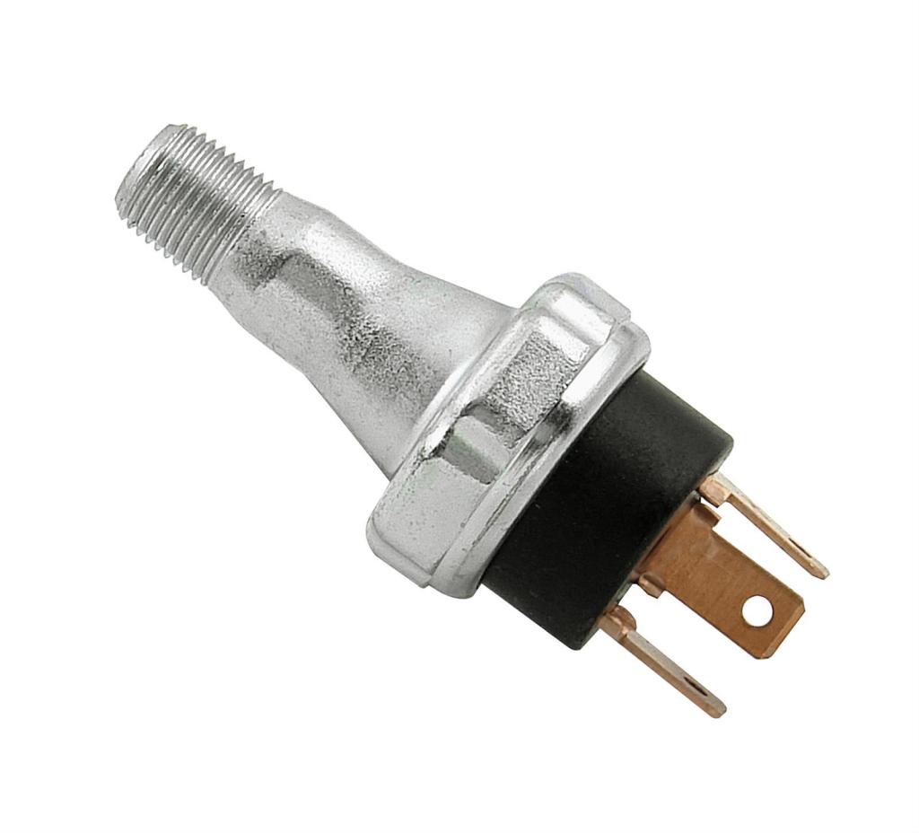

                Using the oil pressure safety switch is a good idea.
                You can still wire in a momentary contact switch to manually run the electric fuel pump tp pre-charge the fuel system to fill the carb after long sitting spells.
                You could also wire in a tip-over/impact switch that would kill the fuel pump circuit in case of an impact/accident.
                Free Shipping - Mr. Gasket Fuel Pump Safety Switches with qualifying orders of $109. Shop Pressure Safety Switches at Summit Racing.
                  plee: I have an electric pump on my Lark, with the pictured oil press switch. After sitting a few days, it does take a some of cranking to get the carb full of fuel. I am planning on installing a momentary switch to eliminate this issue, which again, happens only when the car sits and the fuel evaporates. When I drive the car regularly, it isn’t an issue. IMHO the oil pressure switch is the necessary minimum safety device.
                    The MR gasket switch from NAPA ECH OP6610. Half the price of Summit and no shipping charge. Looking further this switch is no longer available from MR Gasket But summit may have some stock. NAPA shows 30 in stock in my DC.
                    You can run the bypass wire to the I terminal of the starter solenoid, only hot when starting. The wiring diagram https://static.speedwaymotors.com/pdf/5507872.pdf Use the I terminal of the solenoid instead of the ignition switch.
