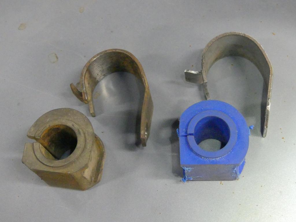

    2) I lost a clamp and bushing on one end of my 1" aftermarket sway bar. To replace it would cost almost 50.00. (they come is sets of 2 and shipping) Thirteen bucks got me two oversized bushings at my local NAPA. An hour in my shop with vice, hammer, bench & ankle grinder, drill press got me a duplicate clamp.

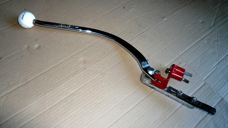

      Ah, just came to think of a solution (among others) I'm pretty proud of; having automatic trans & using the old stick on the column wasn't as tight as when I bought a pure Hurst shaft without any of the linkage parts, made my own pieces & a rod to the lever on the trans:
