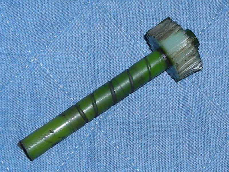

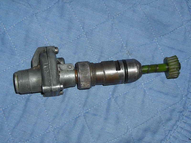

    Where can I find a Speedometer gear like this 22 tooth. Its out of a 1957 Golden Hawk with a 4 speed tranny T 10?

    I don't have my parts catalog here, Anne but the part number could help. With that information we may be able to find one at York.

      You might try SASCO if you get a parts number. I just got one for our 60 Lark from them.
        They handle T-10 gears
          I am just suggesting here, but every factory speedo gear I have ever seen has been fiber, this Teflon gear is not original, and it is obvious that it was not compatible with the drive gear.
          Teeth do not wear on an angle like that unless the angle of the drive gear teeth is different. I would go back to the drawing board and start over.
          Determine what axle ratio, Trans. and tires you have, find the proper gear from the chart in the Parts Catalog and if possible check the tooth count on the drive gear. Then you will know if 22 teeth is what you really need, and will be ready to order/locate one.

              Thank you I will have David check further. This was in the Money Pit so we aren't sure about anything with it. Money Pit is a 1957 Golden Hawk

                The Transmission is a T10-1B
