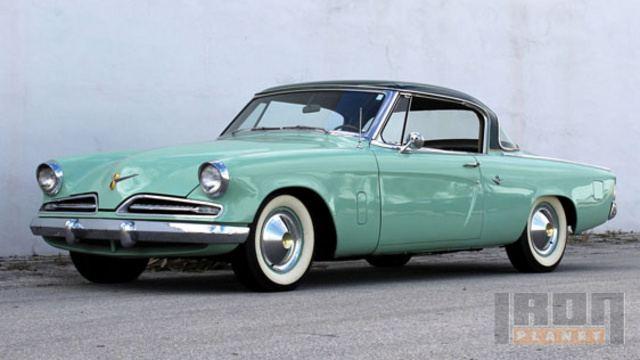

    Also, a Coupe, "C" Body or a Hardtop, "K" Body Champion Six will be worth over Twice as much as a 2 or 4 Door Sedan!

Name:	Beautiful Blue Coupe3.jpg
    Hardtop......................................................................... ...........Coupe
