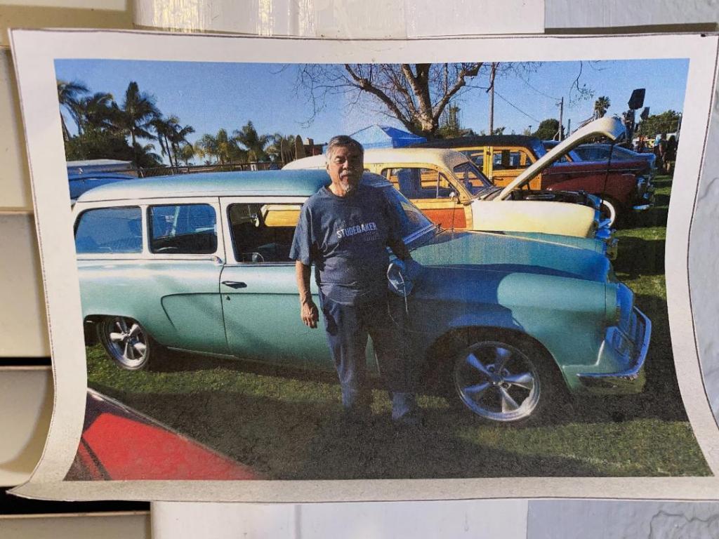

    My father (Charlie Chan, SDC member 072812C), a steadfast Studebaker fan, recently passed. Being I have been living far away across country, he and I never had time to wrench together on his Studey's, he liked to refurbish them. He used to own a Hawk (long sold) and there's a truck (in parts) that sits in the back of the house. We don't know where to begin with the truck (I can't yet find any documentation of it) and there's a chassis, tranny sits elsewhere, can't yet find the engine, and there are parts in at least 4 cabinets. Supposedly all that's needed to get it together is there. Not sure what we'll do with the truck, I'm open to suggestions.

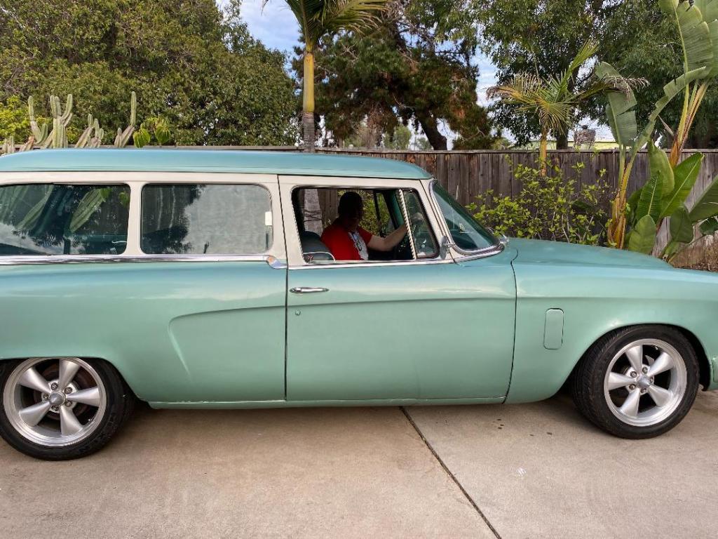

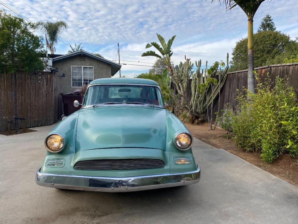

    But alas, I have inherited his '55 Wagon (per the title). But I'm looking to learn more about this car. I've joined the SDC, been reviewing the Studebaker Museum, and Google of course. Seems this may be a Commander Conestoga? I failed to get more pics, I'll be returning in Spring to gather it up for dad's memorial then bringing it North to its new home. Below are pics of dad with it as a show, and me (with one an ode to dad, he was ornery). What I can tell you from memory and what I've been told:
    Nose is altered?
    Carb replaced with an Edelbrock
    Aftermarket wheels
    Several gauges have been replaced

          Thanks PackardV8, he'll surely be riding along. The pic of him I included on my original post will be placed somewhere on the car.

            Welcome to the SDC and to the SDC Forum David! Good to have another Washingtonian here! Are you in Western?
            Your Conestoga definitely has a Cool Custom Trim-less Look!
            Since we know it has an Edelbrock 4 Brl. it's a V8, so if it is the Original Stude. Engine, it's a Commander V8.
            Get that Right Parking Light Bulb replaced. Is it converted to 12 Volt Positive Ground from 6 Volt Negative Ground?

                        StudeRich - Thank you. I am in Bremerton/Seabeck area of WA. I believe it is the original Studey V-8 (labeled Studebaker on the valve covers). I'm not sure if there's a right-side electrical issue or 2 bulbs out, but both right side front and rear indicators are not functioning. I'll dig into it once I get it home, including determining 6v vs 12v - but I do believe it's a 12v battery, so must be converted to 12v? I'm a decent electrician so not too challenging there.
