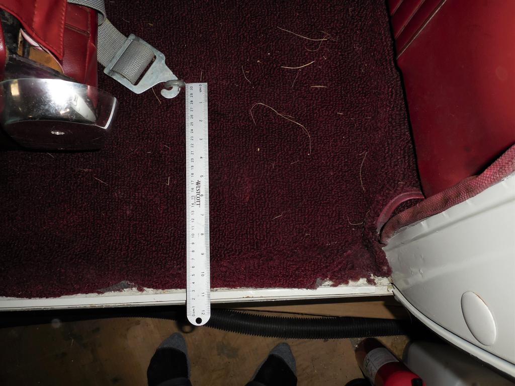

        I have a '64 Hawk and can take pictures of the seat belt anchors - no problem. Seat belts are very important.

              Dwight,
              Would you be kind enough to send a picture or so of your seatbelt install? Haven’t found any good info as of yet for attaching to the floor. I strongly agree with you on the importance of seatbelts. Not going to be driving it very much until we have installed.

                Will do in the morning.
                -Dwight
                  Attached are four pix of my '64 Hawk. Your floorpan should be the same as mine. My carpet and jute pad are somewhat thick, but these pix should get you close enough. There are 3 pix of the front seat belt anchors and one of the back. There apparently have never been any seat belts in the back on this car, but the built-in anchors are plugged by round rubber plugs. The driver's side anchor plug is right-side center in the pic.
                  I believe the eyelet anchor bolt is typical of that type of bolt (i.e., symmetrical). SI or Stephen Allen's probably stocks all the hardware needed.
                  BTW, factory seat belts (outboard side) on a '56 would have been mounted on the door. Personally, I wouldn't do that if I had a '56.
                  Any more questions just ask.
                  -DwightClick image for larger version  Name:	Front (1).JPG Views:	0 Size:	106.4 KB ID:	1905057 Click image for larger version  Name:	Front (2).JPG Views:	0 Size:	113.0 KB ID:	1905058 Click image for larger version  Name:	Rear.JPG Views:	0 Size:	101.7 KB ID:	1905059 Click image for larger version  Name:	Front (3).JPG Views:	0 Size:	141.1 KB ID:	1905060
