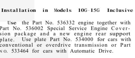

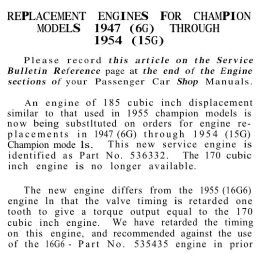

!951 Champion, which in 2019, the former owner said comes with a "new factory 185 C.I. engine". But the plate affixed to the front left side of the block says "Do not remove this plate. This is engine # 536332" and to order parts accordingly. But from what I can tell, 185 motors came with 7 digit serial numbers. Does anyone have any thoughts about this? Thank you.
Help with motor identification
Originally posted by Edsel Face View PostThat's great! Thank you. Too bad it doesn't have the power of the 185 motor. In what vintage shop manual would this bulletin have been posted. This motor must have been sitting around for decades as the prior owner claimed it was "new", installed by the person who sold him the car.Paul

If the replacement engine has been properly installed with the Proper Engine Rear Support Adapter Plate, Oil Pan, Oil Pickup, Crank Pulley, Vibration Damper etc. and the Front Engine Mount Brackets and Mounts from the 170 reused, all you have to do is Drive it!StudeRich
The Fit of the Fuel Pump will be all about Which Engine Mount Brackets and Mounts are being used, 1951 or 1955.
I think if a Champion F/P fits on your Block with no clearance issues, it should be OK.StudeRich
