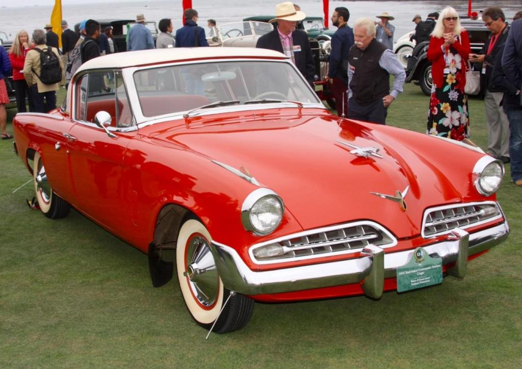

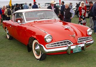

            Carini did --I think it had about 7k miles on it. And he didn't 'murder'it or put gross wheels on it! I'd say the 54 was better 'cause in 53 they did not use the "batwing" crossmember , which ,it turned out was pretty important if you wanted the doors to open and close halfway properly.
              At some point in Late '53 Production or possibly not until '54, they got rid of the unsightly Panel Join seam line across the Lower part of the "C" Pillar, the Larger, Self Actuating Brakes and #2 Crossmember were the HUGE improvements on '54's.
              The only reason some people value '53's higher is they were the first and most recognizable of that Great Bob Bourke Design.
              When it comes to Quality of the build, there is NO Question which is the winner.
ID:	1864184Here is the '54 Commander Starliner that Wayne bought from the Original Owner's Family.
