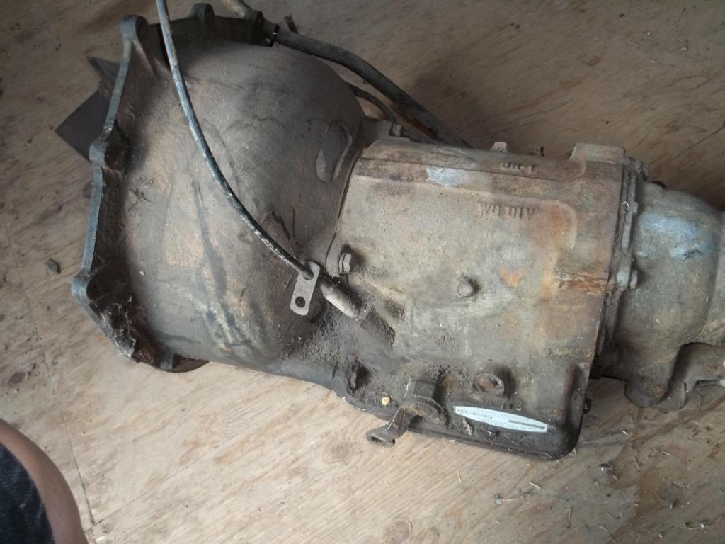

          On the AS-12 transmission, the last part of the number is definitely 5P . The filler pipe comes out of the trans on the bottom left [driver's side looking at trans from the tail end], crosses over under tail section, then comes up the right side. Both cooler lines come out of right side as well. My intention when I bought these transmissions was to use one of them in my 55 President Coupe. Its original trans. was removed before I got the car and replaced with an older standard with o/d. They had to cut the driveshaft. The set-up works fine, no vibration, but I would like to have it automatic. Sounds like it would need a lot of doctoring to do what I planned. I can post pictures of the transmissions if someone wants a closer look. I am in Canada and have no idea where the vehicles these transmissions came out of were built. Could there be a difference on Canadian built vehicles? My 55 was built in L.A. Thanks
            We already know the Converter Housing is not Studebaker, and this Oil Pan definitely is not either.
            A '61 Lark or '62 Hawk or later would have had the Dipstick Tube on the Rear, curving around to the passenger side.
            So the Case says "Studebaker" but was modified to go in something else.
            Maybe an Aircraft Tug! Hey, it's possible!
            I am sure a lot of us would love to see this Converter Housing, especially the Mounting surface to the Engine, it's a Nancy Drew Mystery!

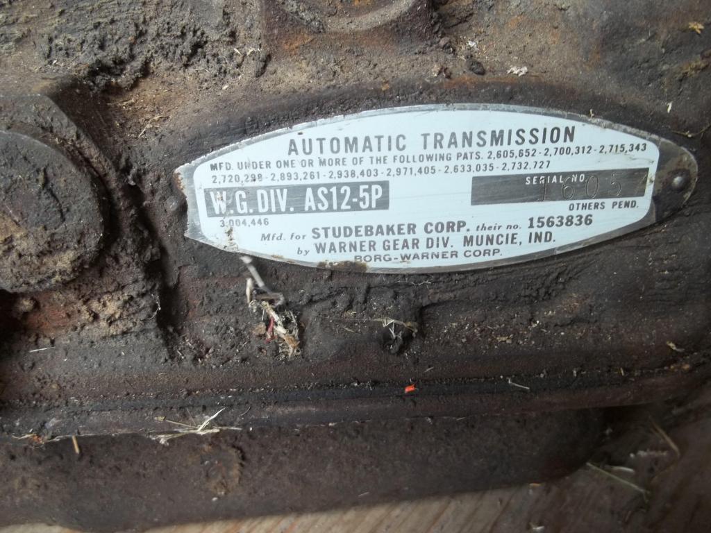

                Most of you guys know what this transmission is. Think about it; a TV cable instead of a rod, a Studebaker label on the trans, and a bolt pattern on the bell housing that doesn't fit a Studebaker engine but looks familiar somehow............
                Restorations by Skip Towne
                  Easy-peasy. That's a Flightomatic for a 65-66 Stude with a McKinnon engine.
                    Also, the actual Studebaker part number 1563836 (65V, 66V) is on the tag! Too bad all FlightOs don't have that.
                      Pictures say a THOUSAND Words!
                      Who would'a Thunk! The CABLE would have been the Big Clue that was not given.
