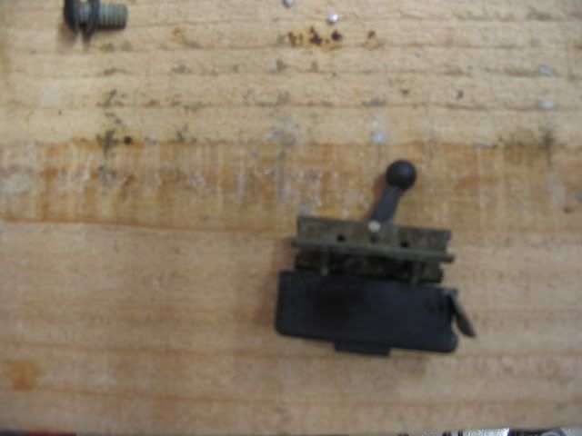

    Well, in the midst of our rewiring project, the map light switch in our cab has been broken beyond repair (don't ask, it's a sore subject around here!). Can anyone tell us whether this is a switch that can easily be replaced with a similar-type switch or whether we are going to have to find another stock part ASAP? Thanks for the input!
    Here's a side view of the switch. The pic's a little blurry, sorry.

    It's just a regular toggle switch (SPST), so any switch that will fit the hole in the dash will work, you just want one with a long enough toggle so it's easy to operate. Graham Gagne in Nova Scotia http://www3.ns.sympatico.ca/kg.works...pdatespage.htm
    has one listed for $7.00 (519157).

        As far as i can tell, the switch you show is not the original Studebaker switch.
        Blade type terminals as shown were not used until much later
        The original toggle switch has one terminal grounded and the map light has one side always hot and the other
        side is grounded through the switch.
        I may have these switches.
        Bob Kapteyn at studebaker@mac.com
