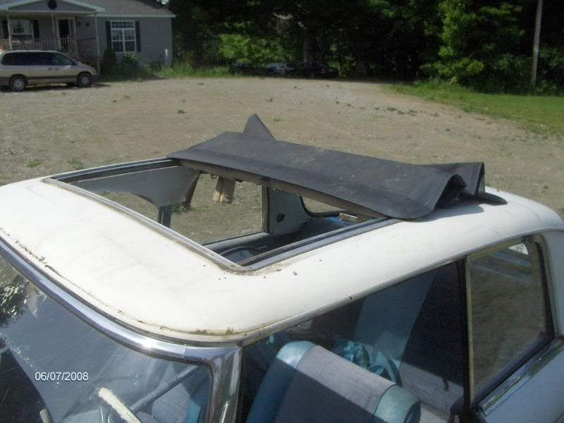

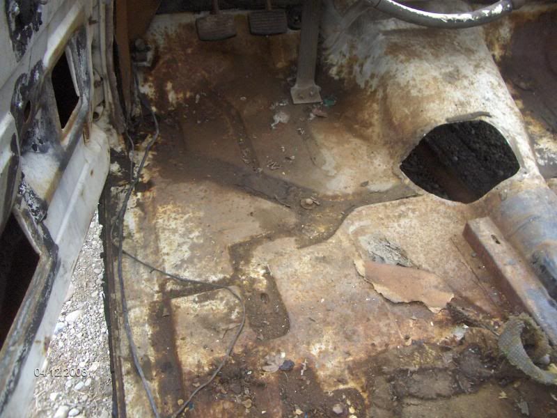

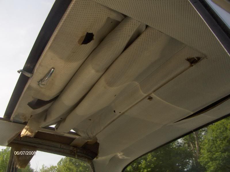

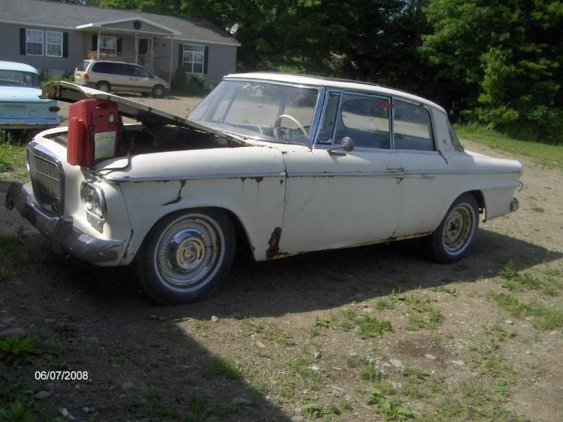

                  A couple pics:
                  How it looks now:
                  Here's the Skytop donor car:
                  The Skytop is REALLY rusted from end to end... still, I'm not keen on junking it But it really is the best use of it. Also has buckets and console in really good condition, just need JP's new upholstery. Also has the foot operated windshield washer, which works, and lots of good pieces. I'll completely strip the interior, remove the roof, bumpers, and fenders, plus the steering box and column to upgrade my 59. The rest, including the knocking 6 banger, will go out back for future parts donations.

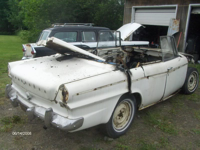

                              THE END OF A SKYTOP
                              This week I got into stripping the Skytop as planned, finishing up today. I was in awe at the extent of the rust, and it totally cured my qualms about junking it[xx(] With the roof off, there was maybe a couple inches of A-pillar left attatched on each side. The rust was accelerated by several remakes with fiberglas, bondo, and floor linoleum. I'll post a new thread with pictures showing why to NEVER fix metal with fiberglas[V]
                              The car yielded the top, decent dash (except pad), and two VERY re-usable front fenders, as well as lots of good trim and bits, and glass, including a nice windshield. Bumpers are fair, but good cores, including guards and extensions. Contrary to many others, this will get the front bumper back on
                              Here's the top, off the car:
                              Here's the Skytop corpse:
                              RIP old girl, and thanks for the parts[:X]
