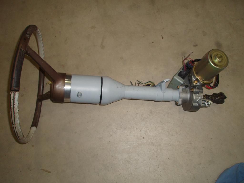

          Colgate, Keithwahl wants to go the other way, put a late model wheel onto a stock column. I too have installed a Studebaker wheel (65 Lark) onto a GM tilt column for my '53 wagon that I am working on (see pics). The only way I see to install a late model wheel onto a Studebaker spline is to remove the steel spline hub from a junk steering wheel and build an aluminum spacer that would bolt to it. This would not be too difficult if a metal lathe is available. Attaching that hub onto the late model steering wheel would be the challenge. You would have to indicate the late model wheel in a mill, face off the back side to get a flat register and then see if you can match up the hole for the horn and and then locate three holes for bolts to hold the new wheel onto the spacer that you made. This is the basic way I did my adaptation but I can't be specific because I don't know what wheel you will be using. Understand that the thickness of the spacer will move the wheel closer to you but this should not be a problem.Click image for larger version
