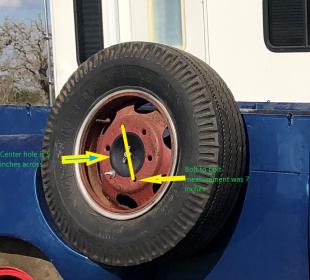

    Does anyone know if anyone makes aftermarket wheels to replace the split rims 6.5 x 16 one on this truck? I cannot find anyone who has any wheels for this particular one; plenty of tires out there. It has 6.5x16 6 lug split rim wheels on it now but no one in TX likes working on one that size so I want to trade them for more modern ones with radial tires.
    Steve
    Texas

    The basic idea seems to be that it is not a split rim, but a two piece wheel. As such it is not as potentially dangerous as a true split rim.

      You just need to educate your Local Tire Store people, let them SEE the Wheels.
      You will likely have to settle for Tubed, Bias Ply Highway Truck Tires.
      Custom Made, Radial capable replacement Wheels tend to be about $2000.00 for 4 !
        Thanks I will download some of these and let them look them over. Most were skiitish that it would not fit on thier big tire safety rack. I tried to explain to them how on the farm we just chain them to a metal pole and use a locking air fitting to fill them up. Dang city kids.

            Call them out for the wimps they are! Texans used to take pride in being real men! No, those are not split rims and no, not dangerous to work on or drive; that's assuming they're not terminally rusty. Find a real truck tire shop or a farm tire shop. There are still farm trucks and forklifts running those wheels today.
            Not so; modern radial tires work wonderfully well on those wheels. I've been using Michelin 215/85-16 with the appropriate tubes and flaps for almost forty years now. The first set only lasted thirty years before they began to weather check. Truck tires are built many times stronger than car tires.
