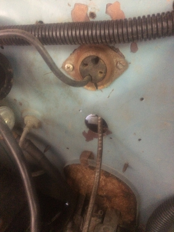

        Jim, on my 52 the speedo cable comes through the same grommet as the oil pressure line. Looks like yours may have been the same at some point. That lower hole is just taped over, looks like it was that way from the factory. I know StudebakerParts has the parts new if you wanted to go that way.
        3H-C5 "The Blue Goose"
          Did not think about this. Does the speedo cable go through the grommet above with the oil pressure sender line?

            Funny, I sent my last post before I saw yours and came to the same conclusion. Do not know why I did not think this through. Saw the hole with the two screw holes and figured that is were it would go.

                Does on mine.

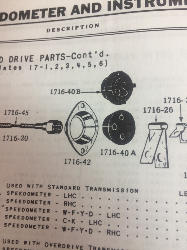

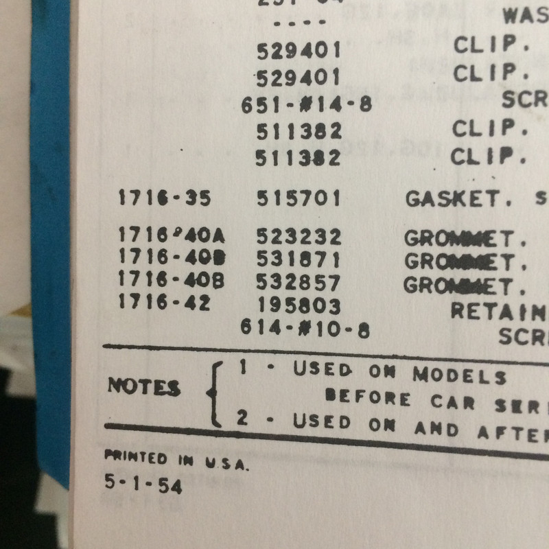

                        The 1716-40A is a 523232 Grommet
                        The 1716-42 is a 195803 Retainer
                        Both NEW on Pg. 124.
                        Then, you can Route the cable in the correct Hole.
