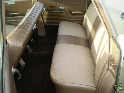

    If you are going for a Original Pattern/Style Seat Cover, it will take a lot more Vinyl than that and way less cloth.
    It completely surrounded the Cloth and went OVER the top about 5 Inches where it meets the flat rear Panel also Vinyl. There is VERY Little cloth.

    Bench Seat, Split Bench Seat or Bucket Seats?
    The BEST way to be sure, is to have your Local Auto Upholstery Shop measure it up, and that way you get a professional measurement. They know how much extra is needed to stitch it up, tuck and hog ring it underneath and all.

                    I think that a Stude Lark wants 8+ yds. to do the whole job.....someone correct me.
                      I was quoted that I need 4 yards just for my back seat on a 64 Cruiser, so I think 8 sounds right.
