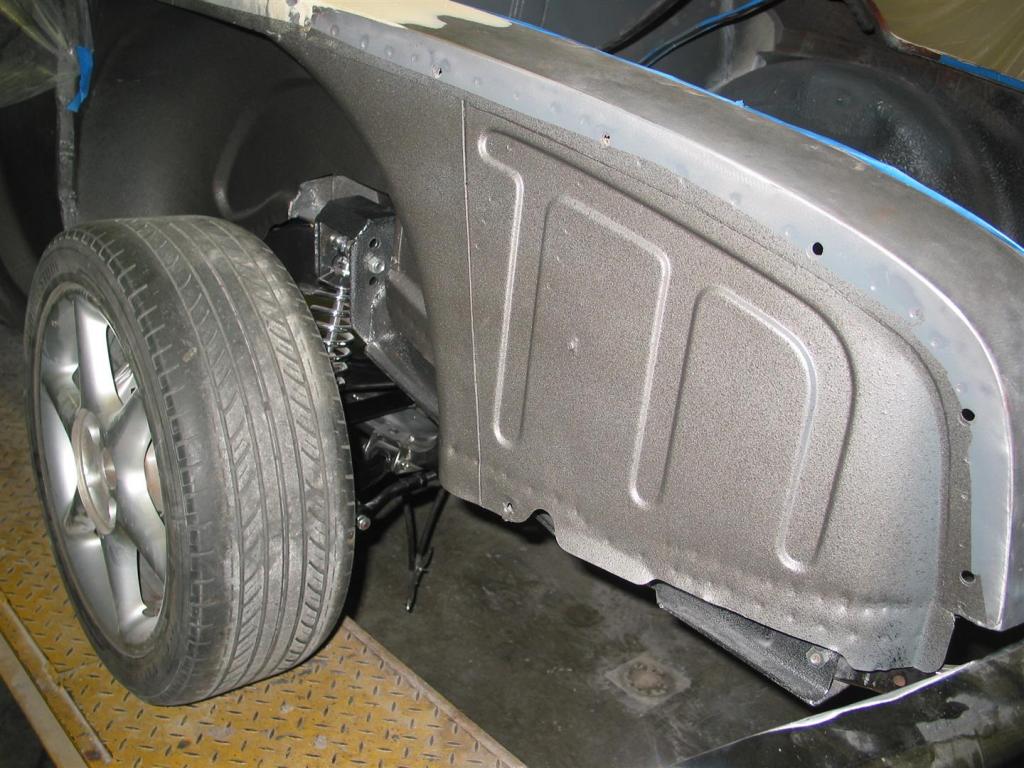

                            I recommend the Upol Raptor urethane bedliner material:
                            The kit is four 1 liter bottles, each about 80% full up to a ring on the bottle, and then a can of catalyst. You pour in enough of the catalyst to fill the bottle and stir it up, very simple. It comes with a special gun that looks very primitive, but works well. I highly recommend shooting the underside or the wheel wells first to get the feel of how it sprays. With a little practice, you can get a fairly consistent orange peel texture. One liter bottle will probably do your roof, as you only want a thin layer, not a thick layer like you would want on a pickup bed. I did the entire underside of my 48 Champion, plus the trunk floor, the wheel wells, and inside surfaces of the fenders, used only three bottles. This stuff is clear, and you can tint it about 10% with whatever kind of automotive paint you are using. I tinted with the same silver grey I used in the engine compartment. Takes several hours to dry. The VW beach buggy had some art work, but you can see the texture. Requires very thorough masking and covering up the area, because this stuff goes everywhere and sticks to everything!
Name:	Bottom with textured urethane.jpg
ID:	1712129 Click image for larger version
Name:	Textured urethane.jpg
ID:	1712130 Click image for larger version
