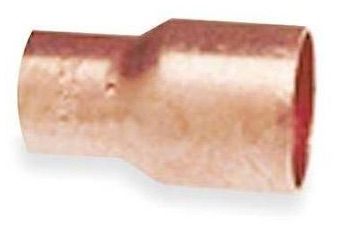

              Could you use a 5/8 to 3/8 reducer like this? You'd sweat a short piece on each end to give you enough room to clamp your hoses? (said the guy with no plumbing experience)
