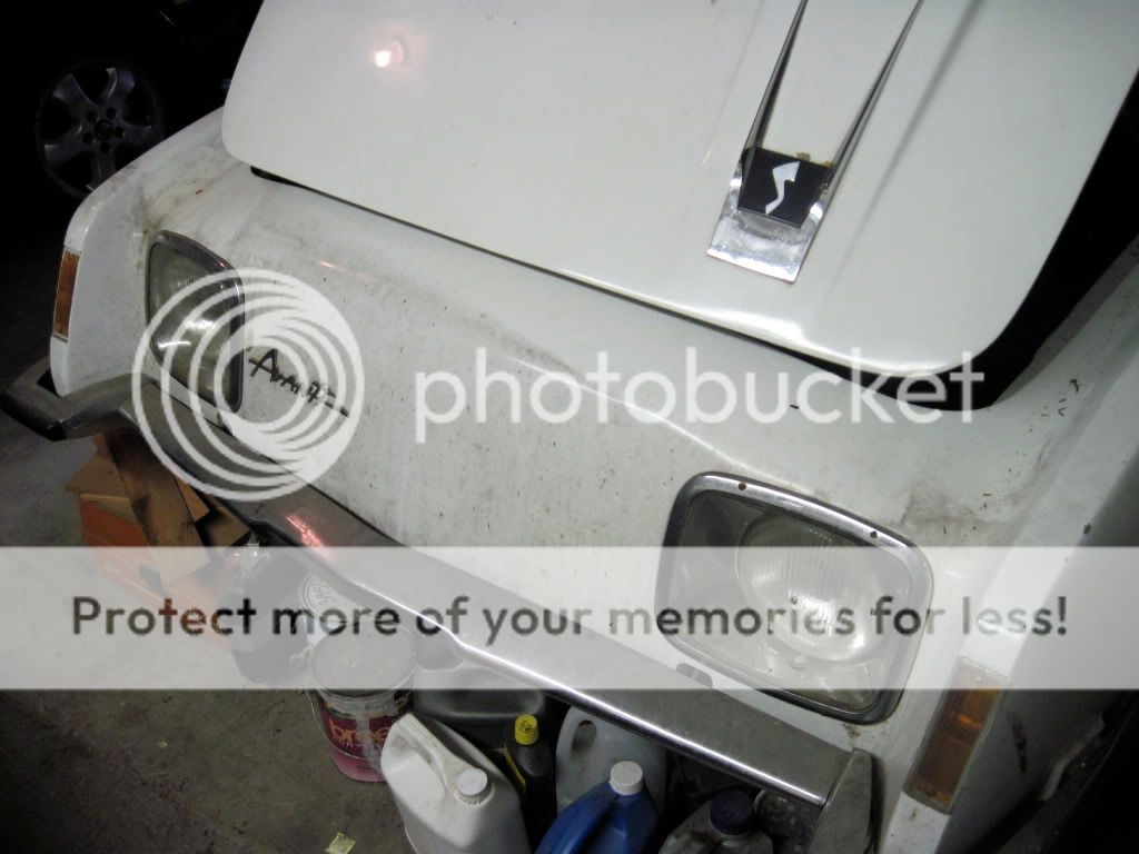

    Would a mule have the later headlights?

        That's a good question, Dave. I always thought I remembered hearing that Egbert's personal car (which sold at auction earlier this year, I think) was the 'prototype' for all the '64 changes and the R3 engine...although I could be wrong.

          Did anyone else notice that the hood lift is on the left - not the right as on production cars?

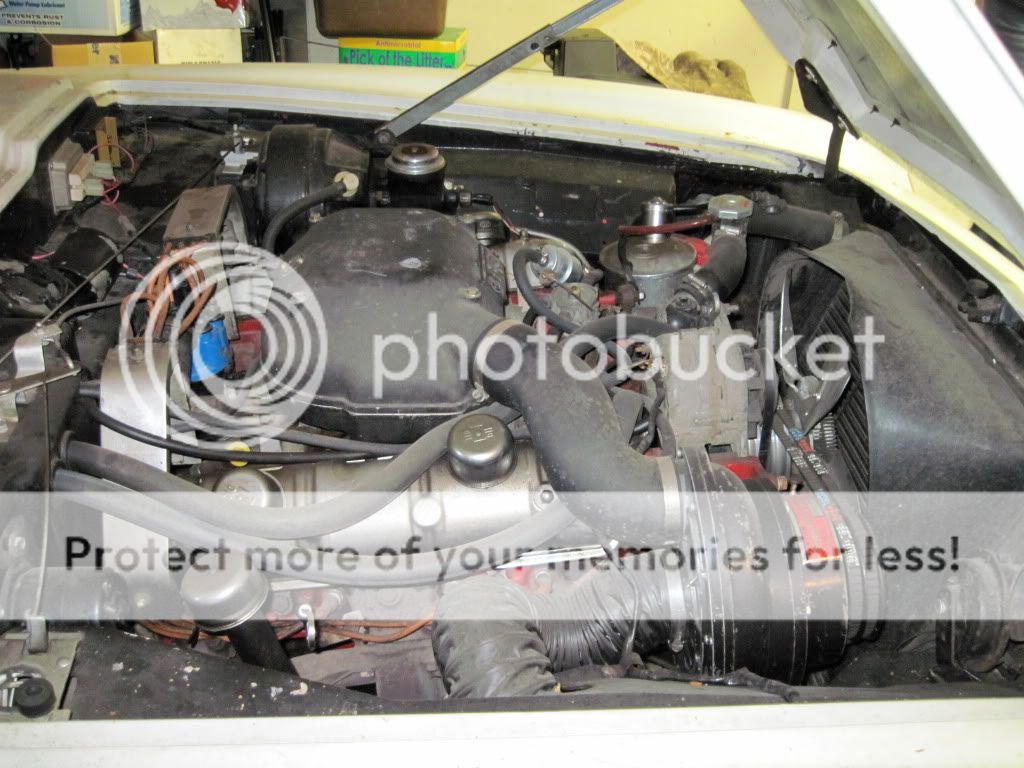

          Also, the vacuum gauge is not production and the heater vent controls are 63 not 64. Hard to tell if the dash is painted or has an overlay but either way it is not production.

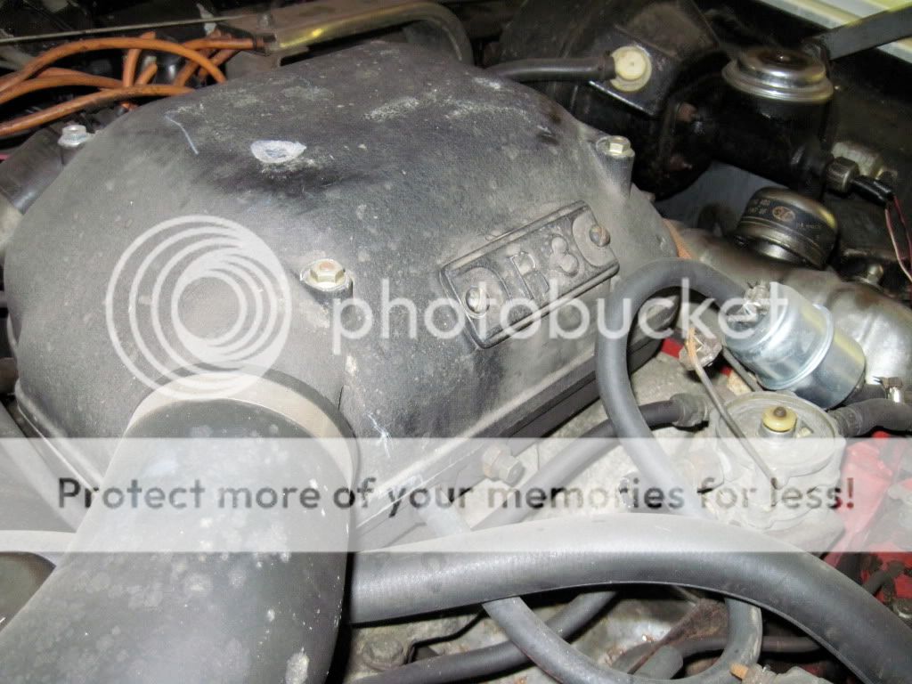

          In the last picture, it appears that the original glass bowel fuel filter is replace with an after market but in the other engine pictures it looks like the original was inverted and fastened to the block.

              I see a number of changes under the hood that must post-date the conversion of the car to an R3, if indeed it is an R3, and not an R2 dressed up. Looks like Mopar electronic ignition conversion; that has to be mid-'70s, and the radiator expansion tank has been replaced by an in-line filler neck, and a separate puke tank provided. There are aluminum water pump pulleys, and a Ford cover with a dipstick has been installed on the steering pump. None of these are necessarily bad things, but with the possible exception of the pulleys, aren't the work of Paxton Products, AFAIK.

                Interesting...it has the red painted block, extra breathers and cold air induction for the air cleaner,all part of the R3 engine. It also has the R3-style 8,000RPM tach.

                    Supposedly the "EX" test cars were updated to '64 specs before being sold. That would account for the square headlight bezels, walnut steering wheel and tilt column, the woodgrain dash and console inlays and different gauges (at least some of them), but anything could have been changed at a later date by someone other than Paxton or Studebaker. It does have an 8 grand tach like a good R3 should. The hood strut and inner body panel for the 3EE battery could simply have been left original. I don't see a battery...it could be relocated to the trunk or simply might not be installed.
                    It sure looks like an R3 engine from the color, the five vented oil fill caps, etc., but it would take getting the numbers off the engine and heads to verify what is actually sitting in that engine bay.

                      The regulator on top of the engine is a Paxton part. This one has been bypassed, and the glass bowl is missing. Mounted this way, the bowl would act as a pressure dome, smoothing out pulses from the pump; rather than a sediment bowl. The return line would have come off a "T" at the pump; if there was one. There are pictures of similar regulators on a Paxton prepared speed record R3 Lark and Egbert's car; but those are the type without the bowl. Because the fuel line isn't steel, a bracket is needed to support the regulator. It forms a shelf for the regulator. None of the pictures I've seen show where it attaches to the engine. I think it must have a kind of "Z" shape; and bolt to the block off plate for the oil fill stack. I'd love to see a good picture of the bracket. The regulator and bracket are Paxton parts, not shown in the Stude Avanti parts book.
                      I think the regulator was connected directly to the supercharger port that normally fed the boost signal to the fuel pump. The regulator simply restricted fuel to the carb unless there was boost. I think it was used with a 9# pump, without boost reference. That could have been simply a Ford diaphragm and spring assembly in the Stude pump.

                        Another interesting point is the cowl vent shows the car started out life as an early '63.
